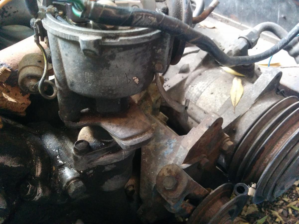

Andrew_L26 Posted December 21, 2015 Posted December 21, 2015 (edited) Hi all, the L28 in my 260z is having some issues with the distributer. I believe it is one that was on the original L26. I'm wanting to replace it with an electronic ignition however I am not sure which setup to use. The motor was originally a turbo model with the P90 head and I do intend on boosting the motor again in the future so I would like something that will also be compatible with that. When I do go turbo I think I will also go EFI with a custom ecu etc. Any idea what would be best for my situation. I'm defiantly not able to spend huge money at the moment but I do need to get the car running again. Thanks, Andrew **Edit I've attached some photos of my current setup Edited December 21, 2015 by Andrew_L26 Quote
Administrators gav240z Posted December 21, 2015 Administrators Posted December 21, 2015 The most common swap is the Electronic Distributor fitted on later L-series motors L24E, L28E etc.. These are Hitachi units and have a module on them E12-80. Found this listed at $300 USD https://www.californiadatsun.com/distributors-and-parts/datsun-240z-280z-e12-80-rebuilt-electronic-distributor.html I recently bought this Mitsubishi made distributor (I've got 2 now). http://www.viczcar.com/forum/topic/606-mitsubishi-distributor-for-l-series-engine-electronic/ These are harder to find, but the build quality is a lot better. I paid $300 AU for the last 1 (not rebuilt) so the first link is not a bad price for a Hitachi unit that was rebuilt. In my opinion don't mess around with second hand ones - unless you plan to rebuild it. The Hitachi unit has a ball bearing cage that breaks and the vacuum advance is often stuffed. So they don't run that well, although probably still better than a points distributor. Here is another option on eBay. http://www.ebay.com/itm/Distributor-Electronic-Cardone-31-619-Reman-fits-79-81-Nissan-280ZX-2-8L-L6-/261852545091 Cheaper than above. Another option that's cheaper is the petronix ignitor here: http://www.thezstore.com/page/TZS/PROD/12-4020 But it only makes sense if the distributor itself is in good shape and not flogged out, worn shaft etc.. This is also a good option to keep the "stock" look if that floats your S30z boat. I've never used this option myself. If I was you, I'd probably look at the Hitachi unit on eBay but I can't vouch for the remanufactured unit's quality as I've never bought it. If going turbo in future and planning to run an aftermarket ECU like megasquirt etc..I would look for a 280zx CAS style distributor. We have discussed this before. http://www.viczcar.com/forum/topic/12249-what-trigger-to-use-for-aftermarket-ecu/ But you'll need the ECU to use this, so might not be an option right up. Andrew_L26 1 Quote

Andrew_L26 Posted December 22, 2015 Author Posted December 22, 2015 Hi all, I fixed my distributor! It ended up being a broken wire going to the points! I'm glad I don't have to invest in another distributor just yet! The car is running fantastically now which is great. Must have been a dodgey connection all along. Thanks for your help everyone. Quote
