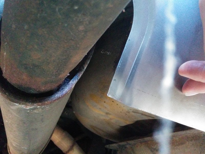

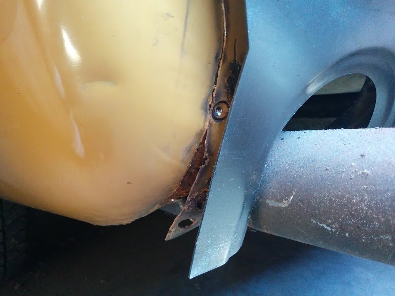

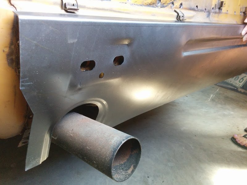

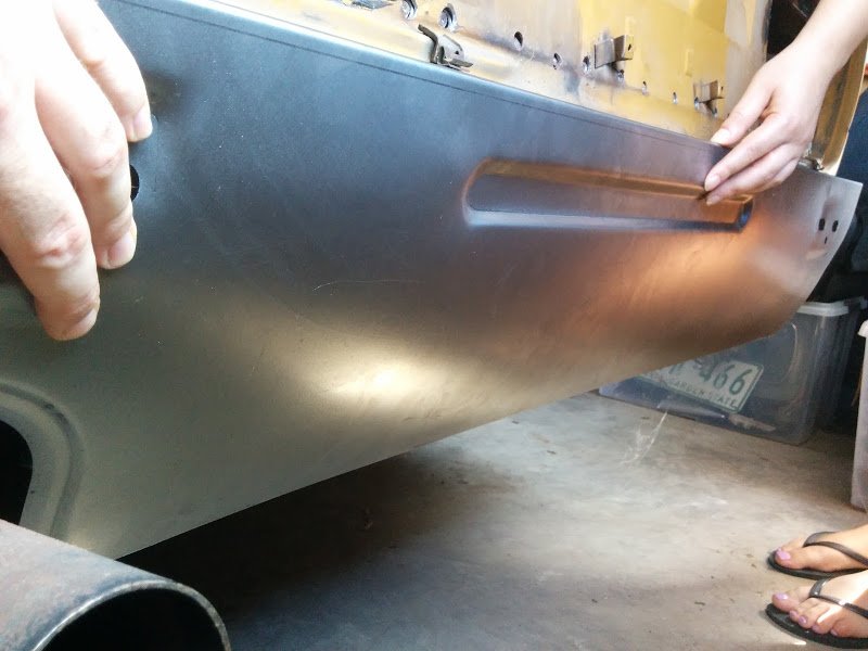

Administrators gav240z Posted February 28, 2016 Author Administrators Posted February 28, 2016 Just an FYI on these, they will need some fettling to make work. They are fairly flat, so will need some more curvature east-west, to do that I am likely going to use a shrinker along the top edge seen below. That should pull it in at each end. You can see toward the bottom also it's not quite as curved as it needs to be to hook under to meet the rear 1/4 panel. Better photo showing how straight it is vs the standard panel. Otherwise the fitment looks quite good and the pressings are pretty decent. I've got 1 spare piece. Price is $450 + postage to you. Quote

Scotty_Rah Posted February 28, 2016 Posted February 28, 2016 Just an FYI on these, they will need some fettling to make work. They are fairly flat, so will need some more curvature east-west, to do that I am likely going to use a shrinker along the top edge seen below. That should pull it in at each end. Otherwise the fitment looks quite good and the pressings are pretty decent. I've got 1 spare piece. Price is $450 + postage to you. Would this panel be suitable for 260z's too? Quote

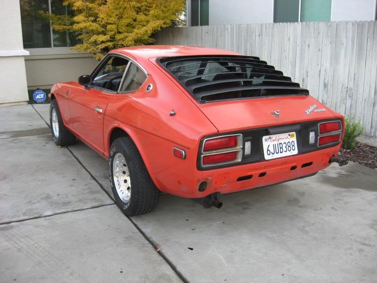

Administrators gav240z Posted February 28, 2016 Author Administrators Posted February 28, 2016 Yes and no, the 260z ones are a bit different in terms of holes in the rear to accommodate larger rear bumpers that North American market cars had. However many owners choose to fill these. Also the indentation is different between 240z's and 260z's. It can still work, but depends on the level of restoration you're doing. I saw a photo recently of someone who put this panel on a 280z but I can't find it now. It can be done, but I've never done it so can't give more details. Scotty_Rah 1 Quote
Administrators gav240z Posted February 28, 2016 Author Administrators Posted February 28, 2016 This might be helpful. http://forums.hybridz.org/topic/116544-1970-240z-bumpers-on-an-early-1974-260z/?p=1096901 Rear of 260z/280z valance panel. I guess it depends on your year of car and may also impact the way rear bumpers fit. Scotty_Rah 1 Quote

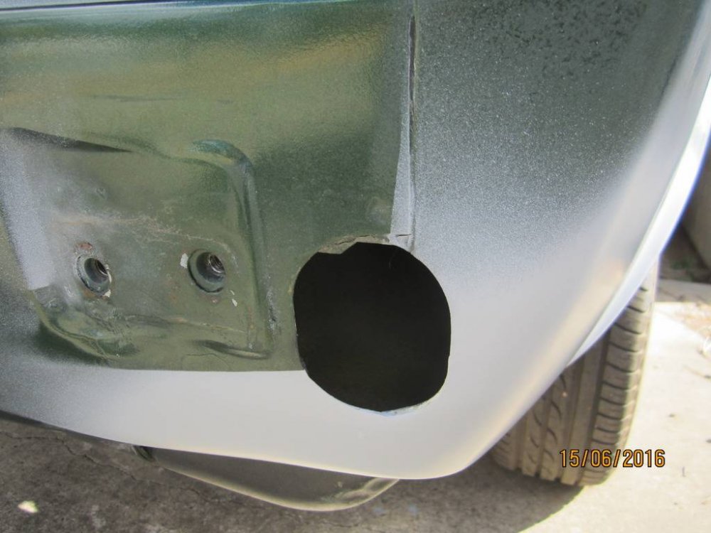

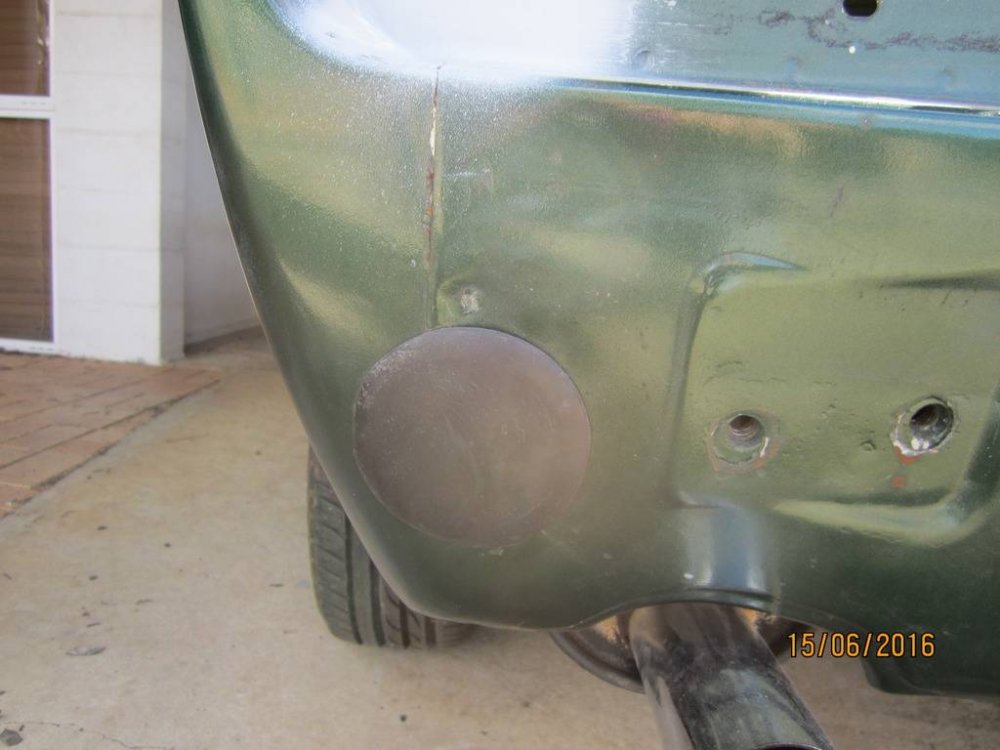

Groundhog Posted June 15, 2016 Posted June 15, 2016 I'm learning fast that the lack of a seam where the two panels join is a sure fire indicator of bog work. Has anyone tried the fiberglass panels for this area. 2+2 Valance below. Quote
