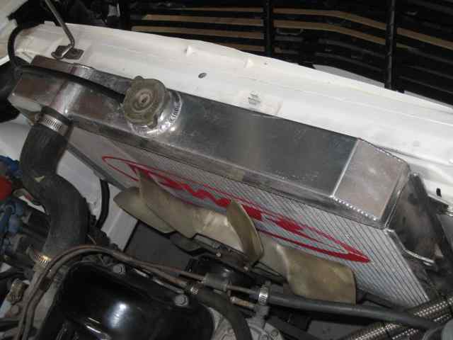

BenZed Posted February 16, 2008 Author Posted February 16, 2008 The PWR radiator is a very tight fit for the engine fan, but it doesn't touch. Fitting the oil cooler was trickier than expected, but it was a cheap kit ($279) and I didn't need any extra parts to make it fit. Quote

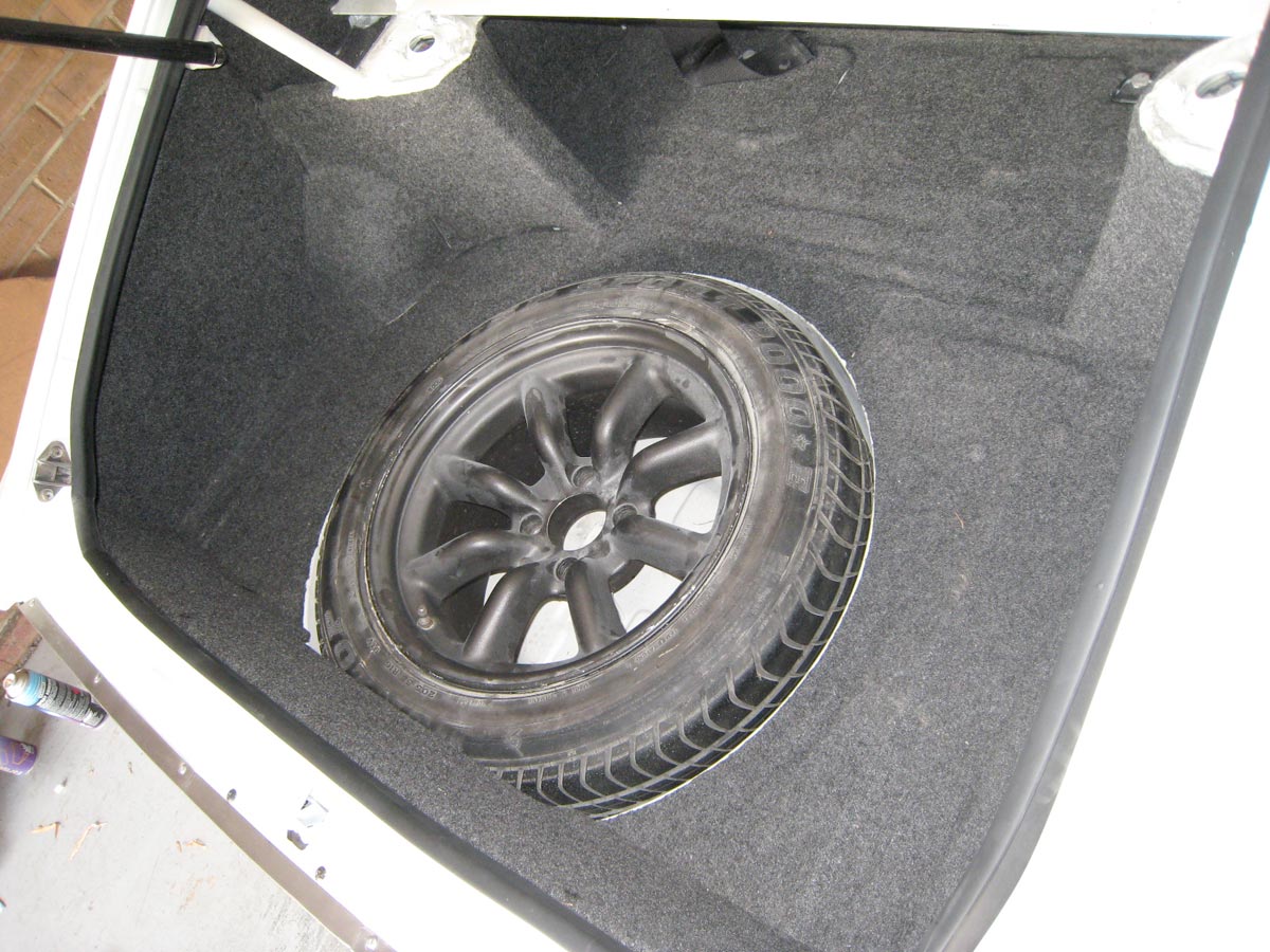

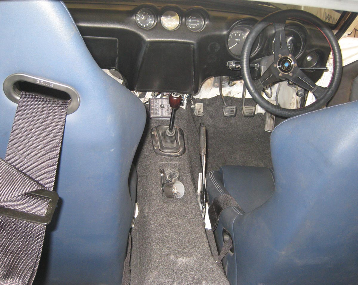

BenZed Posted March 17, 2008 Author Posted March 17, 2008 Another small update, I've just carpeted the interior. The carpet is all unbacked grey stuff like you see on speaker boxes. It weighs almost nothing and you can stretch it easily so it's great for curved surfaces like the wheel arches. I made up new rear panels on either side behind the towers from 3mm MDF, plus a new panel over the tail lights from 6mm MDF. Everywhere else the carpet is glued directly to the painted steel floor. All of the bits that are still visible in white will be painted satin black this week. I don't plan to re-fit the original console, so I carpeted the depression in the tunnel where the choke lever used to sit. This makes a handy place to store bits and pieces. You may notice I also had the door trims retrimmed in black vinyl with dark grey center sections. I'm still waiting on some custom-made induction rams for my injection before I can fit everything, but that should be my next post. Quote

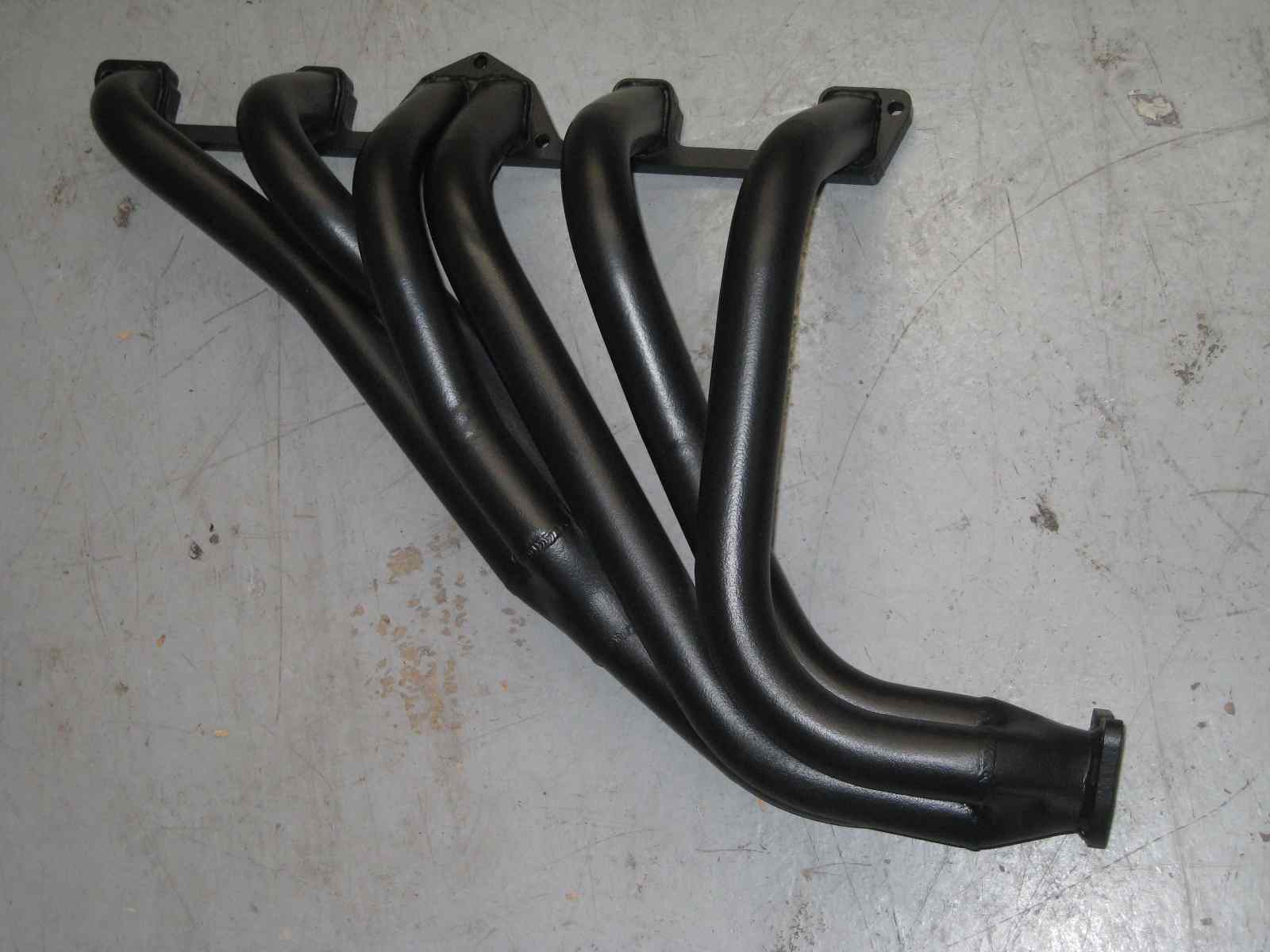

BenZed Posted March 26, 2008 Author Posted March 26, 2008 Just got my extractors ceramic-coated, ready to go back on with the injection. If anyone is interested in getting some coating done this high-temperature black coating cost $400. You can get the polished aluminium finish (slightly lower temp rating) for $320. PM me if you want a quote on other parts (the coaters are next door to my company). Quote

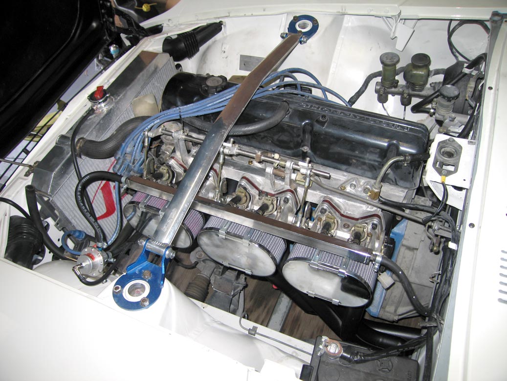

BenZed Posted March 29, 2008 Author Posted March 29, 2008 Just delivered the car to my tuner to get the computer wired up and tuned. I had the aluminium ram tubes you see here custom made to fit inside the filters. Actually there's more space than I thought, so I might get bigger filters later. Need to give it a bit of a clean too Quote
