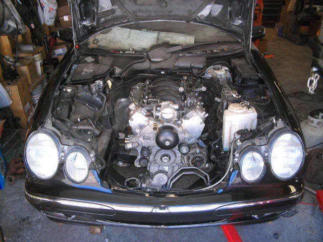

260DET Posted October 2, 2015 Author Posted October 2, 2015 (edited) Unless something extra tasty comes along, the present intention is to build a 3D Sports Sedan using a Merc C class W203 coupe with a LSx donk and a sequential shift auto transmission. The Zed option is just too expensive now, runner C classes can be picked up for $5K . But, unlike some turncoats, my Zed credentials will still be good, 280ZX shorty will do sprint duties Edited October 2, 2015 by 260DET Quote
dat2kman Posted October 2, 2015 Posted October 2, 2015 Lgbook the ZX, it will open up more possible opportunities for it! The w203 Mercs go well in DTM and Euro events. Space frame under shell buiod? Or keep it as a base floorpan, cut sections out as needed? Quote
260DET Posted October 2, 2015 Author Posted October 2, 2015 Seeing that the W203 was designed to accomodate a V6 a LSx should fit OK, the present idea is to leave the body as stock as possible and just add performance items like a body kit, aftermarket suspension, etc. The only significant problem could be the rear end, I have no idea if any other Mercs can donate a LSD, heavier axles if needed and so on. Alternatively I do have a spare R200 LSD. 280ZX has a half cage and will be used as is for sprints only eg the Morgan Park 2016 series. It should be home next week Quote
dat2kman Posted October 3, 2015 Posted October 3, 2015 As it is going to be a lgbooked Sports Sedan, why not cut out the firewall, set motor as far back as possible, and then bx it all in. There'd have to be a diff/cv shaft combo from the bgger bdy cars that should bolt in. Be interesting to see how much kg comes out f it going from Luxo to Stripper! Quote
260DET Posted October 3, 2015 Author Posted October 3, 2015 Firewall is likely to be a double skinned structure and care would have to be taken to not weaken the body but, yes, getting the engine back a bit is a good idea. 50/50 should be possible without too much surgery though. Shortening the tailshaft enough so a one piece item could be used instead of the two piece would be good too, make it a lot easier to get rid of the rubber couplings. But first get the Zed back and sorted, plus get a hoist installed. Quote
260DET Posted October 5, 2015 Author Posted October 5, 2015 Found this pic the other day of a LSx in a W203, looks like there is relatively plenty of room for extractors which there wasn't with the 280. Quote
