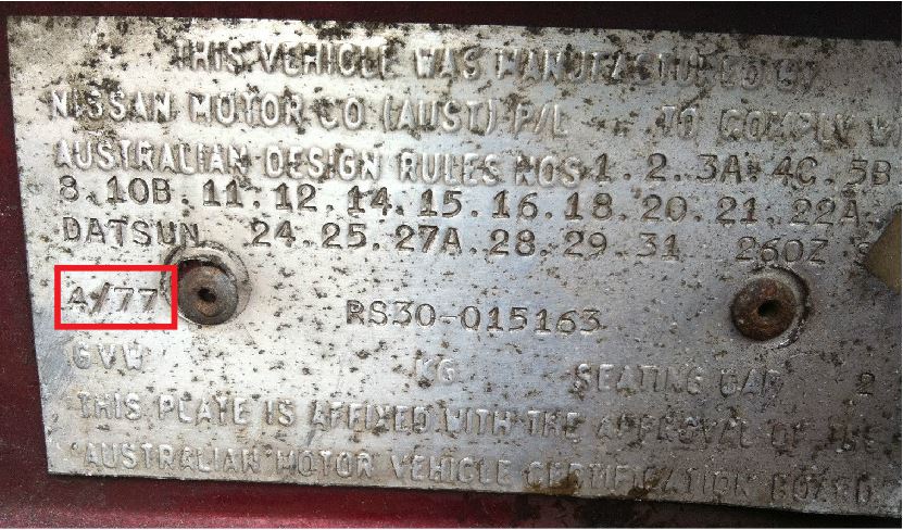

...Lucy is a 1974 model (im not sure what month or how to tell if is early or later 74) ...
Your car should have an Australian compliance plate rivetted to the firewall near the battery. This will show the month and year that the the car was deemed to 'comply' (see example included).
The actual factory build date is not known for 240Z's and 260Z's. Many of the components, including the dashboard instruments and the rear vision mirror, have manufacturing dates on them and can be used to estimate when car was built.

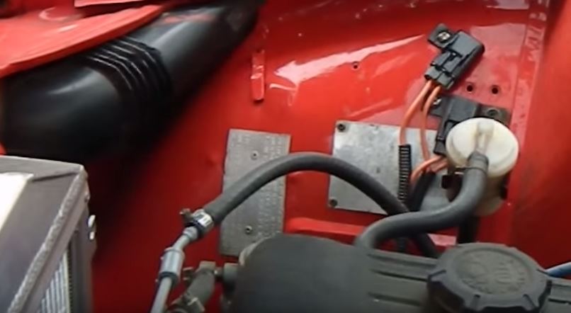

Now, make sure that your compliance plate is not hiding from you. It might be in a different location than on the firewall. Here is a photo of a 260Z that has the Nissan build plate and the Australian compliance plate fitted to the inner driver's side fender - in front of the fuel filter;

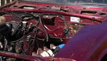

Did you find any holes on the firewall to show where the compliance plate was fitted?
This photo shows one on the firewall -
