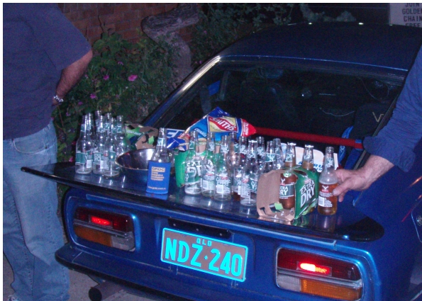

24 Dat Posted August 19, 2015 Posted August 19, 2015 These whale tails also make for exceptional bars at after race meet, drinks Quote
