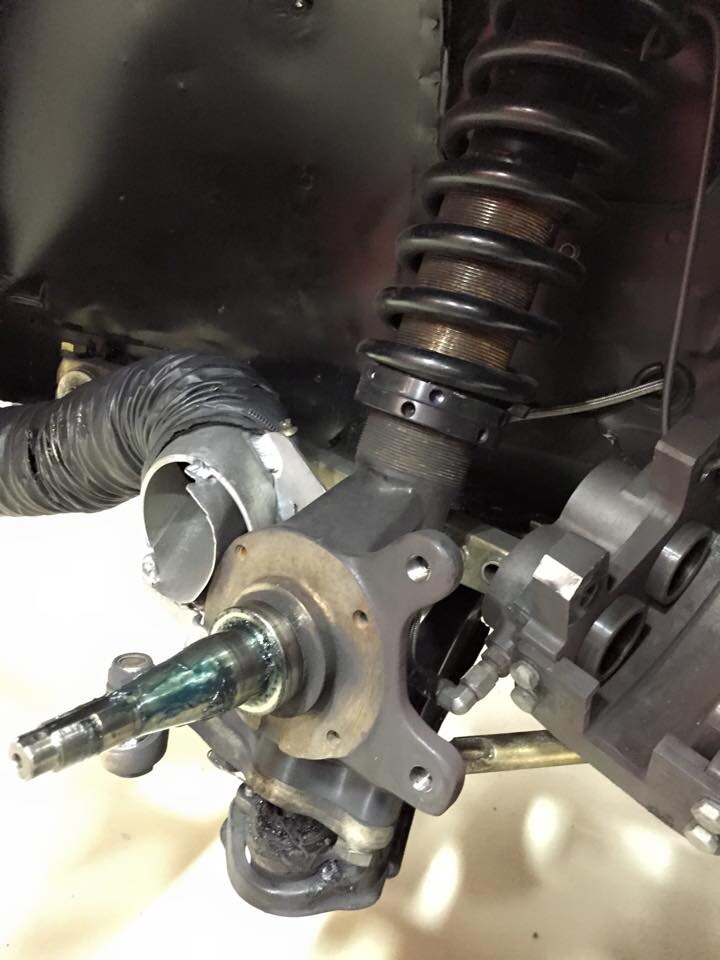

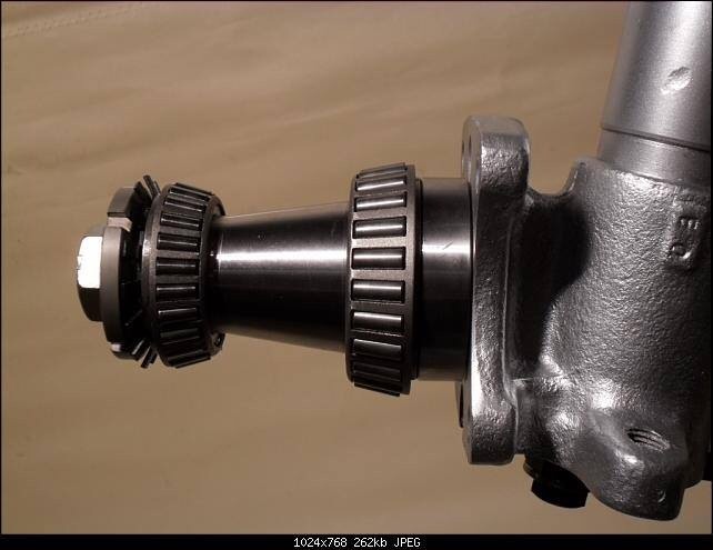

dat2kman Posted April 22, 2015 Posted April 22, 2015 Hope these upload Not Datsun items, but note the bracing welded at top f stub flange, to stop flange flexing out. Second pic, is a machined collar to prevent round stub from flexing, it is carefully faced to correct length to allow correct hearing freeplay. Quote
dat2kman Posted April 22, 2015 Posted April 22, 2015 Above is stub tube thing, Here is flange brace Quote
