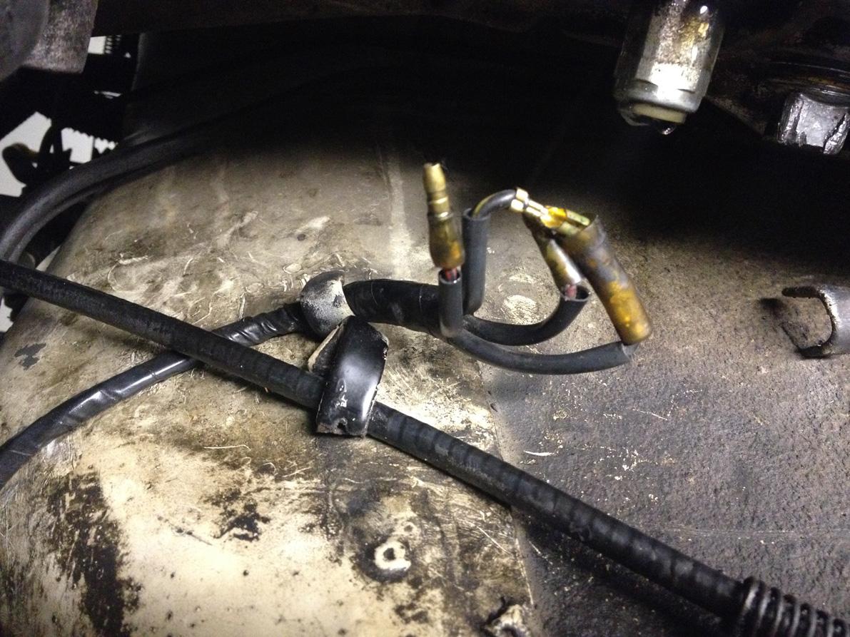

theremm Posted April 11, 2015 Author Posted April 11, 2015 Does your car have the bypass circuit in the engine bay, a push button switch that bypass the circuit for the starter motor? I'm not sure what that looks like sorry..I'll see if I can google an image and look. I should also mention that I have connected the 4 wires with one another which prevent the car from being started in anything but park in an auto. I have tried every possible configuration, as well as only 2 connected etc instead of 4. The starter worked fine (and was relatively new) as well as ignition prior to swap. Quote

mick74 Posted April 11, 2015 Posted April 11, 2015 Hi You need to wire up the inhibitor switch that came off the automatic Black/White and Black/Yellow wires are for the Park/Neutral start, these wires are part of the starter motor circuit (can be used for a kill switch?) and need to be connected to each other. Blue/Red and Red/Black are for the reverse lights and these need to be hooked up the reverse switch on the manual gearbox Try this first before chasing other issues That is what I had to do for my conversion Quote
Retro Z Posted April 11, 2015 Posted April 11, 2015 What mick74 said. There should only be 2 wires bridged together. The other 2 wires connect to the reverse switch on the gearbox. I had the same problem on my car. If that still does not work it means you have a shorting circuit somewhere, find that or re-pin the wires on the back of the ignition switch. Quote

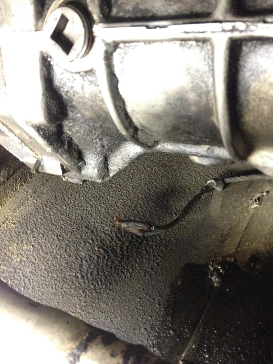

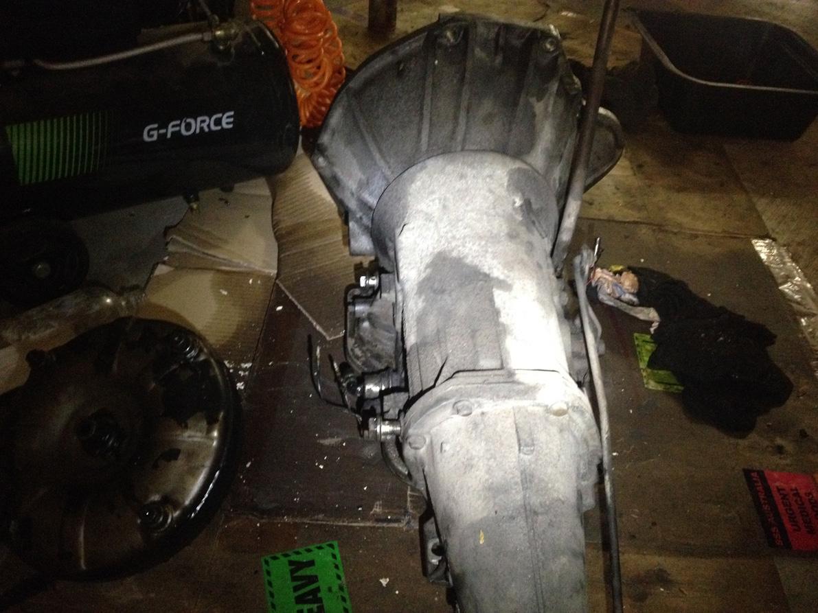

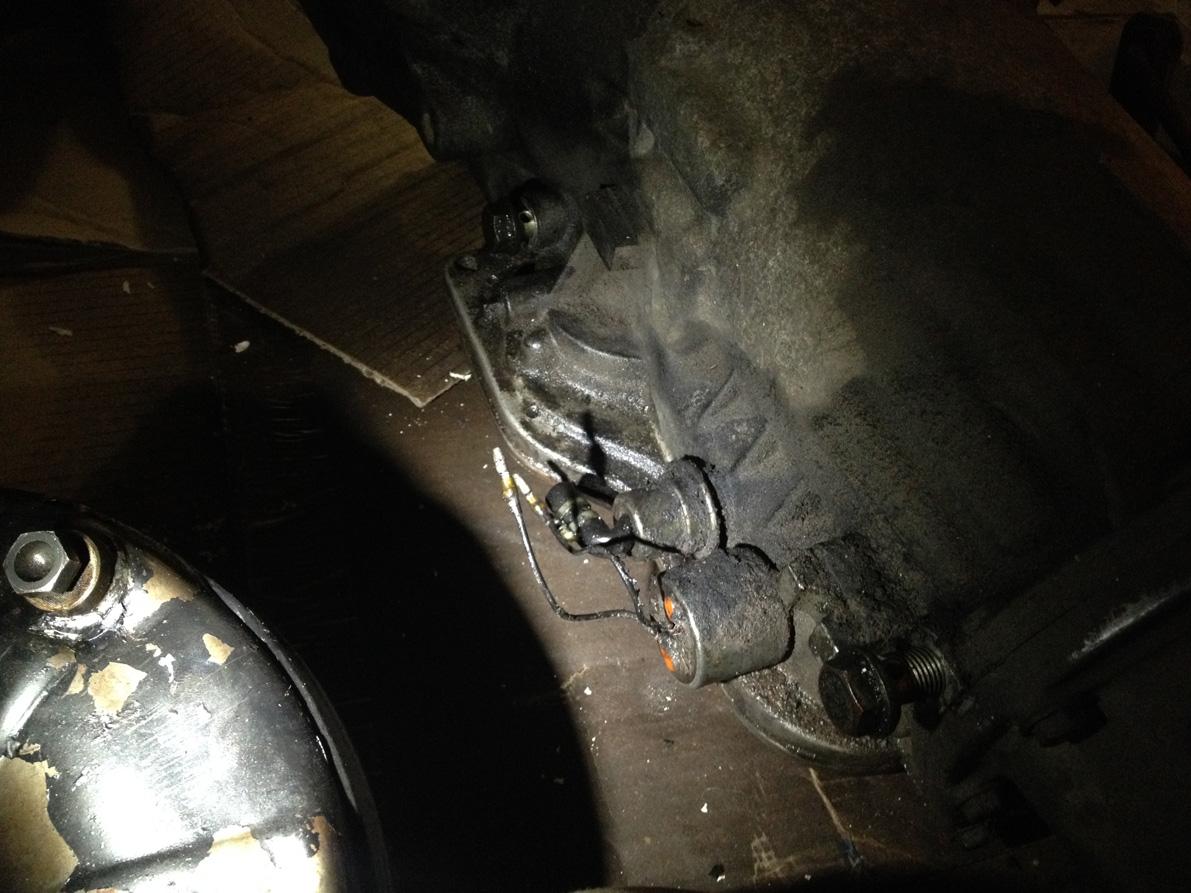

theremm Posted April 11, 2015 Author Posted April 11, 2015 Ok solutions solutions.. Thanks all for your input and mick74 for pointing out the obvious. Silly me, I had connected the black/yellow wires with the red/black wires, as each type of coloured wire had 1 male and 1 female connector. As per Mick's comment, the black/yellow wires go together, so I will need to put a male connector on one of these wires (they both were female) - however temporarily joining these two solved the problem. The red/black wires then go to the reverse switch (which I need to solder wires onto still!!) One final question then. I have 2 loose black wires which currently hang down on the left hand side of the gearbox, which previously connected to 2 x black wires on the auto gearbox, also left hand side. Does anyone know what these are for/what that thing does on the auto gearbox? I assume these wires are now no longer required. Thanks again everyone For future reference to this topic, this conversion was on a '73 240z, using a 71b gearbox. Quote
dat2kman Posted April 11, 2015 Posted April 11, 2015 Possibly 3rd gear sensor/detent swith that retards timing for economy/cruising? Quote
Retro Z Posted April 11, 2015 Posted April 11, 2015 The 2 black wires hanging in the trans tunnel is for the autos 'kickdown' switch. Quote
Six_Shooter Posted April 11, 2015 Posted April 11, 2015 Connecting the 4 wires together is a clue. If these 4 wires were at the stater inhibit relay located on the fire wall then you definitely have an ignition source paying the starter. Though I believe there it's also a ground in there so that should create other issues. Also it seems that not every automatic S30 has this relay. If the wires you connected together are directly off the transmission then that is exactly what had been mentioned above the reverse light circuit is actually powering the starter. You'll likely also find that your reverse lights are on with these 4 wires tied together. I have to ask what ever would make you think that those 4 wires should be tied together? Quote
theremm Posted April 11, 2015 Author Posted April 11, 2015 The 2 black wires hanging in the trans tunnel is for the autos 'kickdown' switch. Thanks I have to ask what ever would make you think that those 4 wires should be tied together? I thought that these 4 wires all formed part of the inhibitor switch... and that the 2 black wires (which I have now learnt are for the auto kickdown switch) were the reverse switch. Silly me Quote
