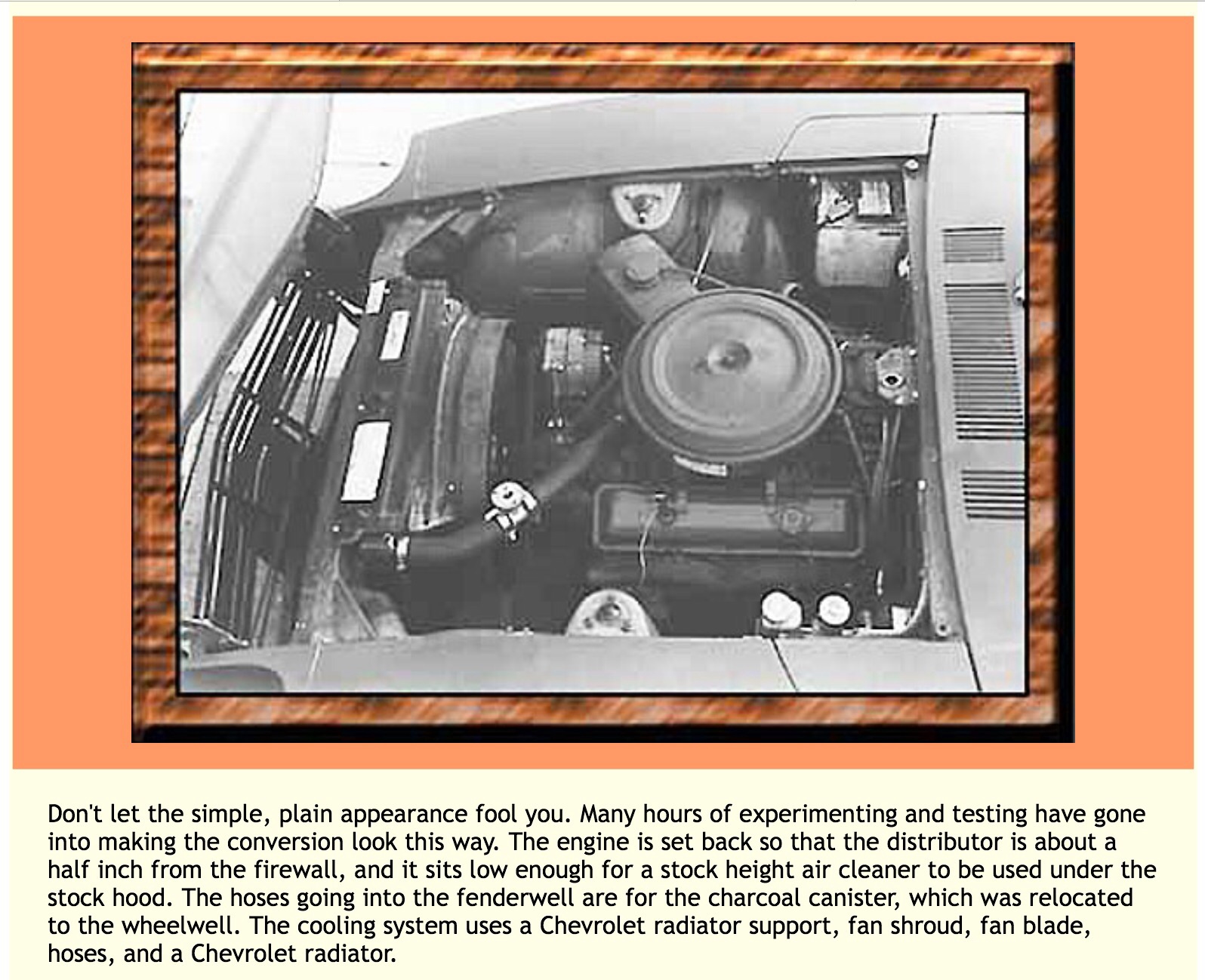

Moderators PB260Z Posted January 1, 2015 Moderators Posted January 1, 2015 Just hide it, mount it in the wheel arch or somewhere else convenient. Use one of another model car, eg, the Subaru ones are quite compact and mount in a wheel arch nicely. Great idea, see below image taken from Jags that Run, Charcoal Canister moved to right side wheel arch, you can see the hoses disappearing behind the strut tower. Quote

Moderators PB260Z Posted January 1, 2015 Moderators Posted January 1, 2015 There's room to fit it on the other side of the Radiator Support Panel too. I think I prefer that idea, is that what you did on Lucinda ? Quote
