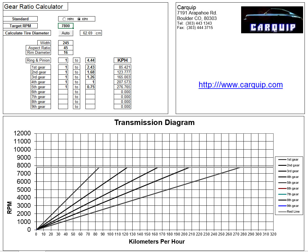

d3c0y Posted October 20, 2014 Posted October 20, 2014 OK here's my 2c worth. I run a 4.44 in my car and it's a borderline race car and i couldn't live with the highway RPM it was going to be doing, so I put an RB 0.75 ratio 5th gear in it. My suggestion is to run a 3.9 ratio Subaru STi R180 LSD. The whole setup will be cheaper to buy than the diff you are looking at and you will have a much newer diff. The 3.9 is relatively easy to get as far as STi R180s go and has the SureTrak torque sensing centre. It's bolt in; all you need is an R180 mustache bar and wolf creek side axles, which should all up coming in under $1300. The R180 is lighter too. I have some neat spreadsheets that plot your gear ratios on a graph so if you give me your tyre size i can tell you the RPM at 100kph. For a 225/50/16 (I have to read these off a graph that just has 1000rpm increments): 3.9 ~ 2750rpm @ 100kph 3100rpm @ 110kph 4.11 ~ 2900rpm @ 100kph 3300rpm @ 110kph 4.375 ~ 3200rpm @ 100kph 3500rpm @ 110kph Also for interest's sake, I put in some ratios that gave me a little over 2000 rpm at 100kph and it would need to be way down around the 3.0:1 ratio (about 2200rpm). If it is indeed that tall, it's going to be very sucky. Going up to a 3.9 will make a massive difference to the way it drives. Pic is of my Kameari CR box and is just for reference. The day I rev out 5th in my car is going to be an exciting one. As usual, my conversion is documented on my facebook page Garage San Maru, link below. Quote

d3c0y Posted October 21, 2014 Posted October 21, 2014 So, with that 0.75 fifth gear, the RPM drop/reduction on upchange from 4 to 5 is quite massive, compared to rpm drops, in every other gear on upchange. Be a bit un-inspiring! Yeah but it wont be completely shit to drive around for the 75% of this car's life, not to mention I couldn't drive it out to warwick or any out lying events without wearing the crap out of the engine and using a ton of fuel. Red line 4th to 5th will drop in back to 5900rpm at 205kph so its fair in the meat of the power band and there wont be many tracks that will need more than 205kph. 5th gear can be for the PI main straight. What would you suggest I should have done Jason? If it's crap, i'll just send it back to PMC to stick a 0.83 on it I guess? Quote
