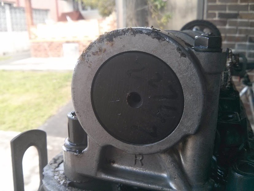

Administrators gav240z Posted September 11, 2014 Administrators Posted September 11, 2014 Sorry to drag this slightly off topic, but if you look here: http://www.viczcar.com/forum/index.php/topic,13624.msg148669.html#msg148669 You can see a number written on the camshaft. 22747 Is it likely this was a re-ground camshaft profile? If I get the vernier calipers out and measure the lobes will we be able to determine camshaft size and spec that way? Quote
luvemfast Posted September 11, 2014 Posted September 11, 2014 Vernier measurement, you can only measure lift. "Zero" vernier while measuring base circle diameter. Measure lobe. Multiply value by 1.5, for rocker arm ratio. That is lift. Quote
