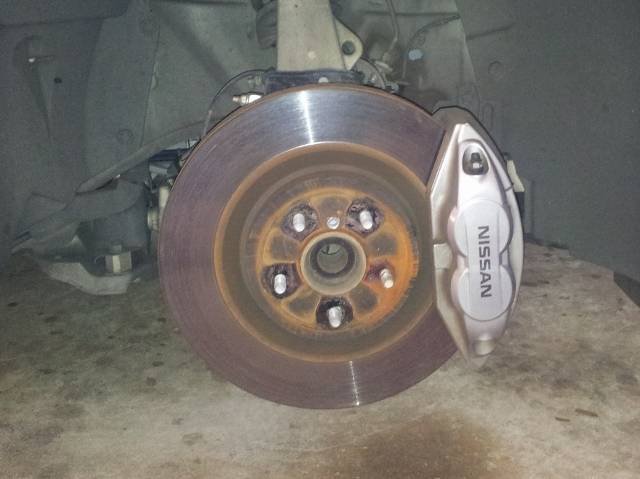

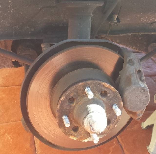

I went from a car with these:
to these:

I have Silvermine stage 4 fronts (vented hilux s12w) 'next size up from the zstore ones you linked' and r31 rear brakes with the patrol 1" master cylinder and stopping power is amazing. So good that i have purchased another set for my friends 260z.
All up costed me around $800 for everything new discs front and rear, hoses, caliper rebuilds, master cylinder etc.
PM Scoota G. He makes the rear caliper brackets and can even rebuild and modify handbrake mechanism for you at a very decent price.
