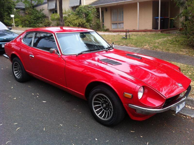

Datsun260z Posted May 25, 2014 Author Posted May 25, 2014 Thanks for the welcome guys here's a picture of my z Quote
George Posted May 25, 2014 Posted May 25, 2014 Looks great with the hurricane wheels. When was it last painted? Quote
Datsun260z Posted May 25, 2014 Author Posted May 25, 2014 Looks great with the hurricane wheels. When was it last painted? Hi George - thanks-she looks awesome but cant say when was last painted but certainly does appear to be recent work. Quote
Moderators Zedman240® Posted May 25, 2014 Moderators Posted May 25, 2014 Welcome and great looking Zed! I'm interested in those mirrors.. any knowledge from what they are from? Quote
Datsun260z Posted May 25, 2014 Author Posted May 25, 2014 Welcome and great looking Zed! I'm interested in those mirrors.. any knowledge from what they are from? Hi Zedman- mirrors came with the car (and they are very limited in their positioning/adjustment),although they do look very era correct- which is why I will probably keep them. Must admit though I am a little partial to fender mounted mirrors and am giving that look some serious consideration-what do you guys think ? Quote
George Posted May 25, 2014 Posted May 25, 2014 You said it, they are period correct. I wouldn't be changing them. Quote
