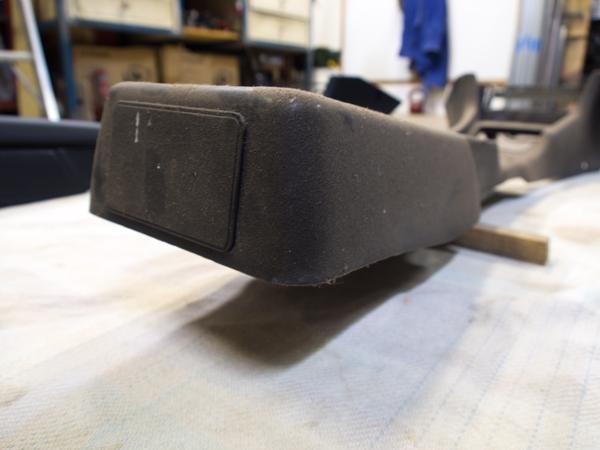

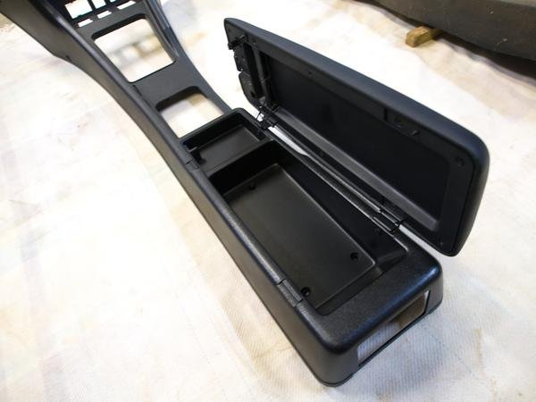

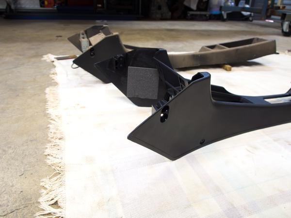

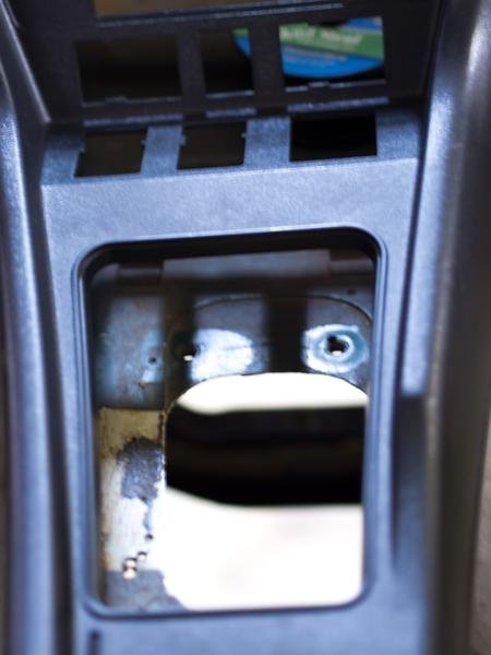

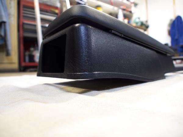

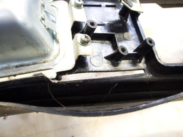

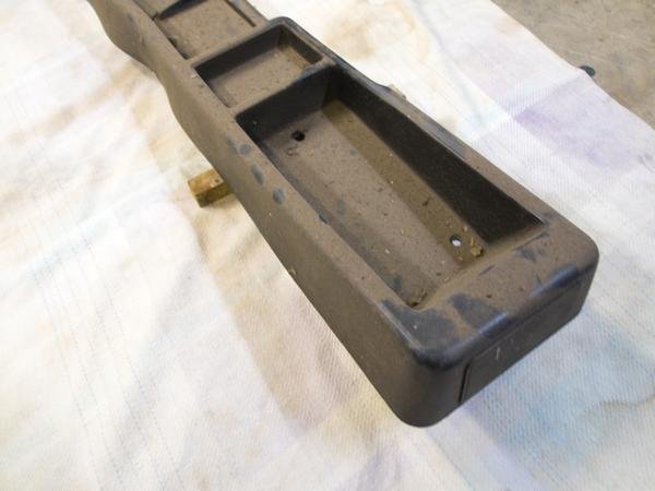

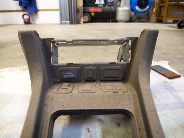

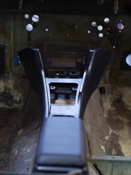

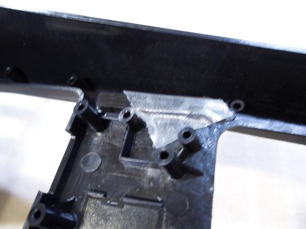

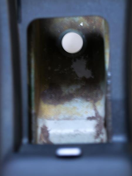

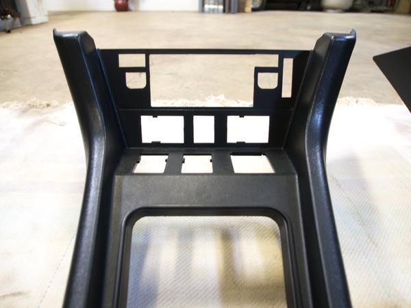

fly-s30 Posted May 17, 2014 Posted May 17, 2014 Hey everyone, as promised this thread is to see the visual similarities and differences between an RHD ADM 260z center console and a LHD USDM 280z center console. Right off the bat the differences are obvious. There is a ~10mm flare added right around the lower section of the console, presumably to add a bit of necessary rigidity to the console, as most now show signs of warping due to heat, time, sunlight, so on. 260z 280z 260z no arm rest 280z With arm rest 260z Choke slot 280Z Choke slot with blanking plate: This is a poor fit, but can be massaged into place. This is good for those running Auto choke or EFI systems as the lever becomes redundant Ill let the rest of the pics speak for themselves Ashtray area: If you look closely the mounting points on the body forward of the shifter under the defogger switches/ radio fascia are are pretty much in line. The rear mounting holes were aligned in roughly their correct position to give this location. I couldnt find the bracket im supposing will be here to confirm that. Final location: Just a word of caution if you were to purchase a new one of these. The only parts that come with the console are the blanking plate for the choke, and the arm rest. Everything else needs to be brought over from your old console The last price for this was $US 164 with $US 60 postage to Victoria from ebay seller: http://www.ebay.com.au/usr/nissanofchesapeake?_trksid=p3984.m1439.l2754 The seller was really good to deal with, and allowed for combined postage. I had checked with other ebay sellers and none were happy to ship to aus. Please do your research to make sure it fits in your car 100% as i hadnt mounted it in any of those pics. In saying that, I have checked with local nissan dealer and this is NLA to Australia since the Jap tsunami; so this really looks like our only option if you going to replace the tired and twisted examples us aussies have. Kudos Darius Quote

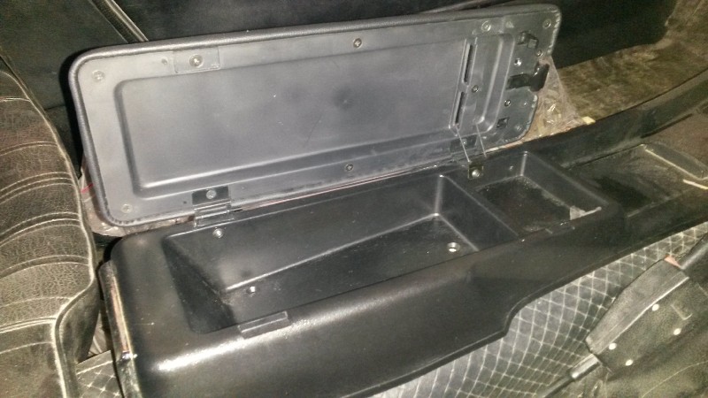

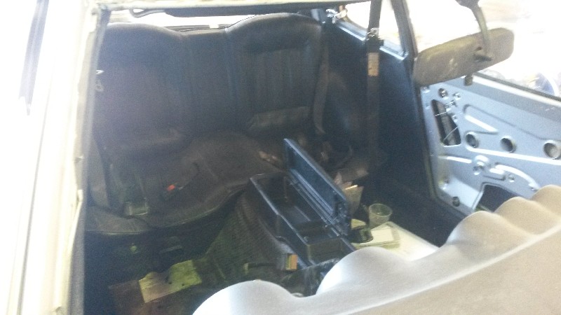

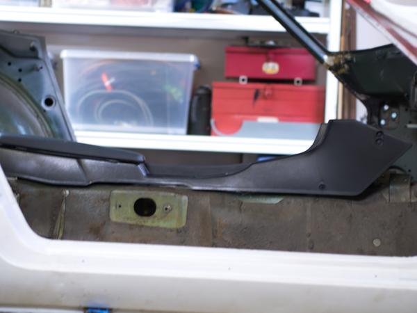

Ledge Posted May 17, 2014 Posted May 17, 2014 Here is the same USDM console, But ive converted the lid to open the correct way for RHD Sorry about the poor pic quality Quote
fly-s30 Posted May 17, 2014 Author Posted May 17, 2014 Here is the same USDM console, But ive converted the lid to open the correct way for RHD Nice! Can you get close up of what you have done? Soooooooo....then console fits fine then? Woot! Quote

gilltech Posted May 17, 2014 Posted May 17, 2014 The early 260s like mine didn't have lids on the consoles & no provision for fitting them. I don't know when lids were added as standard equipment. The later 260 console I also have which I obtained from a parted-out JDM car ('76 IIRC) has slots both sides to enable hinging for LHD or RHD and push-in plastic blanking pieces for the redundant slots. Looks very similar to the 280z one in the pictures. There were (are?) aftermarket lids available in the US for non-lid consoles which attach differently. Quote
Ledge Posted May 18, 2014 Posted May 18, 2014 Its pretty simple. even the latch setup in the lid swaps over. The only issue will be the catch you need to cut and reglue the correct way and the spring you need to carefully bend the other way. Quote
