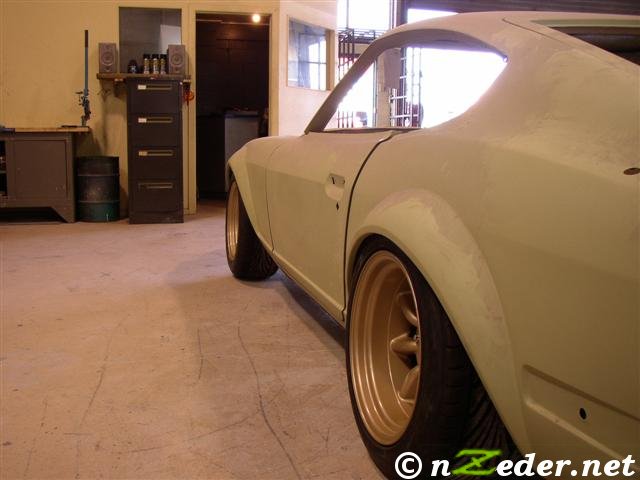

NZeder Posted November 4, 2007 Posted November 4, 2007 Ok I have some 16x8.5 -6 and 16x9.5 -19 RS Watanbes with 225/50/16 and 245/45/16 - however my car is not on the road yet (still waiting for the panel finish) but I have installed them on the car to check if the custom flares were ok. So here is pic with on the car you can see the stretch (not too bad) this pic was taken with no springs to check the clearances (just blocks of wood at lower than full coil bind). I hope this helps Quote
Toecutter Posted November 4, 2007 Posted November 4, 2007 Very nice Mike. Thats gonna be one tough looking Z when all done. Quote

zedevan Posted November 4, 2007 Posted November 4, 2007 i like the amount of flat you have at the edge of those flares nzeder, and it looks clean with the shaved rails, very awesome Quote
NZeder Posted November 6, 2007 Posted November 6, 2007 i like the amount of flat you have at the edge of those flares nzeder, and it looks clean with the shaved rails, very awesome Thanks man - it is a long time coming the car has now been off the road 10 years. What do you mean by shaved rails? Quote
modular9 Posted November 6, 2007 Posted November 6, 2007 Zedevan : Shaved rails = shaved rain rails? Which look like you have shaved them off ... which is FLIPPING AWESOMe looking. Very envious. Quote
NZeder Posted November 6, 2007 Posted November 6, 2007 No rails are still there I guess it is just the angle etc - it rains too much here in Auckland not to have them...then again it would look cool....hmmm stop putting idea's into my head. Sorry for the hi-jack but back to the rims/tyres - so what tyre will you run with Fu? The issues is getting anything larger than 245/45/16 you can get 255/50/16 but that makes for tall tyre = clearance issue and if you go slicks you can get 265 something (well you used to be able to here in NZ) Quote
