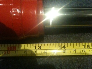

Gareth, I ended up getting a set of Z31 KYB (just GR2's) from Baz - I measured them as being only 5-7mm shorter than stock at the front - haven't tried the rear yet (possible the 30mm you mention was the rear?).
:-\ Not sure what's going on there, here's the body length on mine. I would've thought the rears would be longer than fronts, I'll see If I have the part number from them.

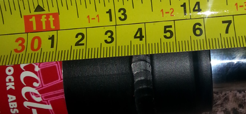

The plot thickens further re the z31 shocks.. my kyb gr2/excels are 36cm... longer than Gareths kyb agx's. I have 4x kyb 365056.. supposed to be z31 fronts... perhaps Gareth has rears or a different variant of z31 (eg. turbo/non turbo?)
Heres a pic.
