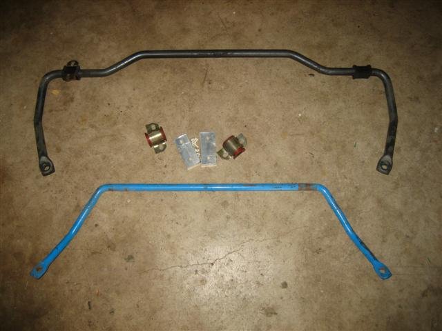

nat0_240_chevZ Posted January 6, 2014 Posted January 6, 2014 yes def different. 240s have a 2 inch or so offset forward from the swaybar mount/pivot between the 2 bushes 260z not, is straight. The above I can confirm, id tried it previously, but other way around. the 260z mounts appear further forward, 240z on and inline with the front diff cross brace in the floor, 260s more infront. Not 100% confirmed but i think the bus and the coupe bars are the same or very similar. 240z rear sway/anti-roll bar bar pic note the forward offset between the mounts. (top one in pic) 260z rear sway/anti-roll bar bar pic note the forward section further forward between the mounts. (longer arms) nat0 Quote
