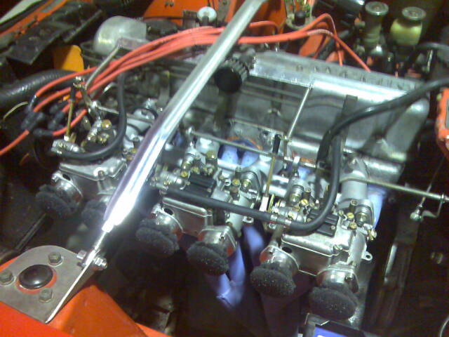

Toecutter Posted April 18, 2008 Author Posted April 18, 2008 Mike, I ran my carbs on a fresh set of plugs and they worked fine but fouled after a few short start and stops. I then installed the return line as I found the mechanical pump was pressurising the the carbs. The fella at a local Alpha garage that sets up Dellortos quite a bit advised the return line orifice/restrictor should be at least 3mm the stock rail has approx 1mm hole so I drilled it out to 3mm, (he advised that when they are set up on Alphas they have a return line with no orifice plate and still fine, and thats with 500cc per carb throat). I've installed the old rail as for now as I did'nt have a through type banjo on the last carb. Anyhow the result is the same you get fuel return working with no pressure build up and running approx 2 to 2.5 psi. Dimitri (Zedman240) very kindly gave me a hand and Mick74 of coarse always ready to share his well of Dellorto knowledge has got me to a point where my carbs are running very nicely. I ran the car pretty hard for a couple of ten minute sessions and found all plugs to be burning nicely when inspected. I will however install the 55 idle jets as I think 60 are too big. I have also bought 5 off 7772.6 emmulsion tubes and looking for the last one if anybody has one to sell please advise. Cheers, Sulio Quote
Toecutter Posted May 24, 2008 Author Posted May 24, 2008 Well since last update I have installed the 7772.6 emmulsion tubes (previously 7772.10) and also 55 idle jets (previously 60's). The car is more responsive and more power from idle to 5000rpm. new emulsion tubes it's running richer mixture, Current power peaks at 5000rpm. I believe the 130 main jets are too small and need to go bigger. Perhaps 140's. See how she goes once they are installed but might even look at bigger air correcotrs. An updated settings progress chart below: 2745_.pdf Quote

Toecutter Posted October 6, 2008 Author Posted October 6, 2008 Well my final set up. Sulio Final Settings, 06/10/2008 L28 DHLA40L chokes 32mm 7848.3 main jets 130 air correctors 195 emmulsion tubes 7772.6 idels 49 air bleeds reduced to 0.9mm from 2.0mm* pump jets 38 Stock L28, N42/N42, elec dizzy, headers NOTES: 46 idle was too lean at 2500rpm. Gradually leaned out so was'nt far out. 49's provide a great progression. No hesitation any where does'nt matter how it's driven or what rev range with what should be the best possible economy as any lower on jetting mains or idle runs it too lean. No further tinkering required. Sulio 4306_.pdf Quote
warrenz Posted October 7, 2008 Posted October 7, 2008 For the record my final set up is:- L24 DHLA40G Chokes 32mm Venturi 7848.3 main jets 125 air correctors 190 emmulsion tubes 7772.8 idle jets 46 air bleeds reduced to 0.9mm from 2.0mm* Acc pump jets 35 Stock L24, Standard distributor with Pertronix Electronic ignition, headers, 2.25" exhaust. One carby is modified to connect vacuum advance. Pretty happy with that. Warren Quote
