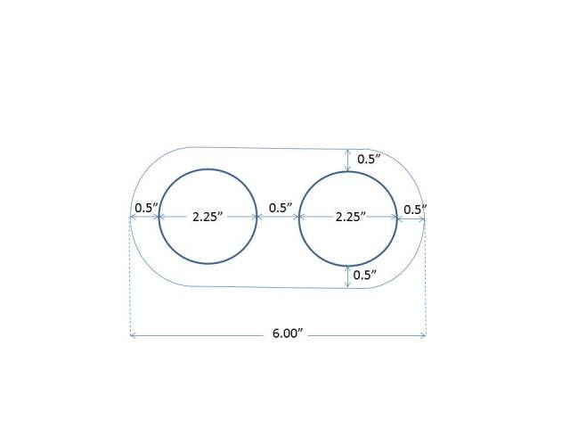

KatoKid Posted July 29, 2013 Author Posted July 29, 2013 What are you looking for in particular I run a exhaust shop and do lot of custom work there are lots of options out there But id need more info to make a recommendation Regards mick Hi Mick. Have a look at the last page on my build thread for the general idea. See below for a profile of the resonator which would be 24 inches (600mm) long. Excuse the imperial but I relate to that better when talking pipe sizes...its a little like dick sizes...no one quotes millimeters! Quote

zed240au Posted July 30, 2013 Posted July 30, 2013 Checked all the mufflers I could today but nothing matches the sizes u require Spoke to our supplier that makes mufflers to order he was concerned with how narrow u want muffler suggested if u could squeeze it out to 7" wide he would be much happier to make Would suggest u check your car see if u can squeeze 7" for the length u want Id think u could as im running twin 3" pipes on my car with gap between them and still clears tunnel Id suggest u allow 3/8 to 1/2" gap around muffler I can still make u a muffler up to your size if needed let me know if u can squeeze in extra inch Mick Quote

KatoKid Posted July 31, 2013 Author Posted July 31, 2013 Checked all the mufflers I could today but nothing matches the sizes u require Spoke to our supplier that makes mufflers to order he was concerned with how narrow u want muffler suggested if u could squeeze it out to 7" wide he would be much happier to make Would suggest u check your car see if u can squeeze 7" for the length u want Id think u could as im running twin 3" pipes on my car with gap between them and still clears tunnel Id suggest u allow 3/8 to 1/2" gap around muffler I can still make u a muffler up to your size if needed let me know if u can squeeze in extra inch Mick Hi Mick. 3/8 to 1/2 inch gap is pretty tight? I'm running standard BMW engine mounts so there will be the normal amount of deflection of hard acceleration and deceleration, the last thing I want to do is to have to change things after I have it on the road to avoid the exhaust hitting anything. Can you elaborate as to why the extra inch is so important, I think I can guess but would like to hear from you? Thanks Nato too. Quote

zed240au Posted July 31, 2013 Posted July 31, 2013 With the width I think the size u suggest is very narrow for the pipe size of 2.25" Any commercial built mufflers like this are 8" wide even hotdogs would be 3.5' wide by 2 total 7" U need some space inside muffler to make it work Id be concerned that with only .5" around outside of tubes how effective muffler would be Might even be worth considering 2 long hotdogs or even 4 shorter hotdogs instead of custom muffler We have had lot of success doing this on VE commodores v8s I know 3/8 to 1/2" don't sound a lot but my rule of thumb fitting systems is if I can get my finger tip in the space little chance of it hitting works on most systems barr some diesel turbos which do torque a lot Would think the Bmw mounts would be reasonably solid and not allow a lot of movement On my car im running 2 15"spiral mufflers in front of diff and 2 12" hotdogs under diff with single rear muffler in standard placement spirals and hotdogs being 3" internals are 4" outside diameter Mick Quote
