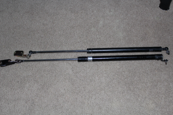

mossy Posted March 14, 2013 Posted March 14, 2013 Can anyone tell me which hatch strut in the pic is for a 240z? Quote
Retro Z Posted March 14, 2013 Posted March 14, 2013 My 73 is the top one. By looking i guess either will fit guess the 2nd rod would just open it higher? Quote
gilltech Posted March 14, 2013 Posted March 14, 2013 While you're at it add one to the other side, a la 260Z, much better. Quote

Six_Shooter Posted March 16, 2013 Posted March 16, 2013 The 240 will use the bottom strut. When that one is installed on, the access to the bolt heads will be towards the inside (middle) of the hatch. The other one would place the access to the outside. Which would mean it gets installed on the right side (Driver side for you Aus people). Also the bottom strut looks more like my '73 strut than the top one. Quote
gilltech Posted March 16, 2013 Posted March 16, 2013 The bottom one looks the same as on my '74 260, & also a spare I have off a 240. The top one doesn't look like any S30 Zed one I've ever seen. Also looks too short. Could be off anything, or quite possibly an aftermarket generic replacement. Quote
Retro Z Posted March 16, 2013 Posted March 16, 2013 I'll try upload a pic of mine tomorrow. Mine is definately the shorter top one in the pic. Could be aftermarket but i have another of the same in a box that were removed off a jap fairlady z parts car. Quote
gilltech Posted March 17, 2013 Posted March 17, 2013 FWIW, my 260 2-seat pair & also my RH spare off a 240 - originals - are approx 635mm measured pivot-bolt centre (body end) to centre of rawl pin on bracket (hatch end). I still reckon the top one in the photo looks like a generic replacement, with it's bolt-on ball-stud mountings at both ends. The only part that looks Datsun/Nissan is the bracket for fixing to the hatch. The lower one looks genuine, still with it's Nissan sticker which matches mine. Quote
mossy Posted March 17, 2013 Author Posted March 17, 2013 I think you guys are right because as mentioned the longer one has a nissan sticker the shorter one doesn't ( i thought it did but it was just japanese writing) Quote
mossy Posted March 17, 2013 Author Posted March 17, 2013 Thanks Locky, looks like the longer strut I've got is actually a right side strut as the mount that bolts to the hatch on mine is flipped the other way but the gold mount on the other strut is for a left hand fitment ( I"m guessing thats what the "L" stamped into it means ) so I'll swap the gold mount out to the longer strut then fit it up! Quote
