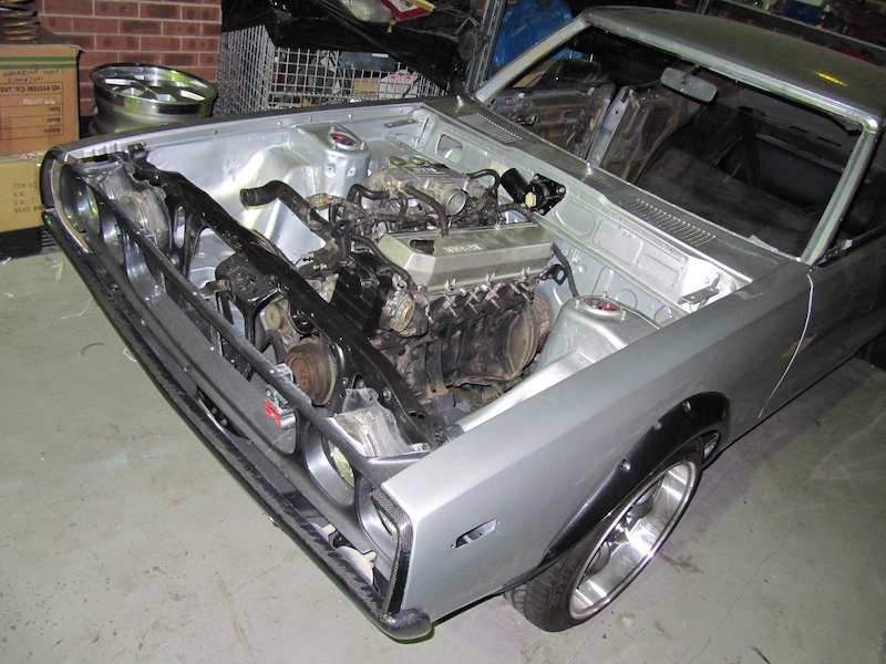

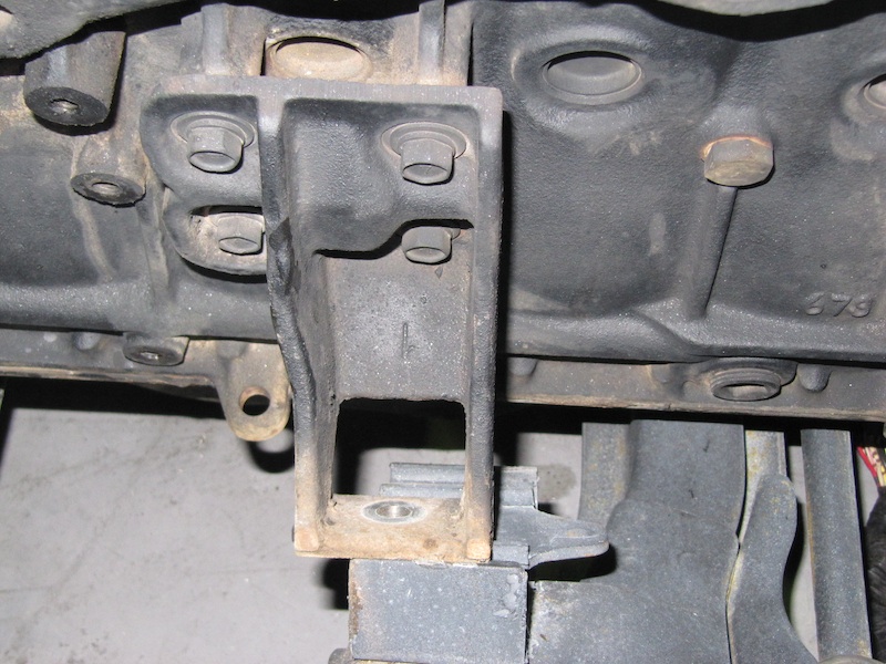

    The engine is now sitting in place properly. With a bit of mild violence I got the R31 mounts to fit in the 240K crossmember. Also picked up a set of used extractors and had them ceramic coated.

    Ok back to the car. Some good progress now, I have got the RB30E engine and gearbox sitting in the car, pretty much a perfect fit. Only needs plates welded onto the original mounts for the engine, not sure about the gearbox mount yet. 240K tailshaft will be fine without mods. Gearlever also in the right place.

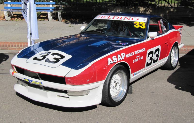

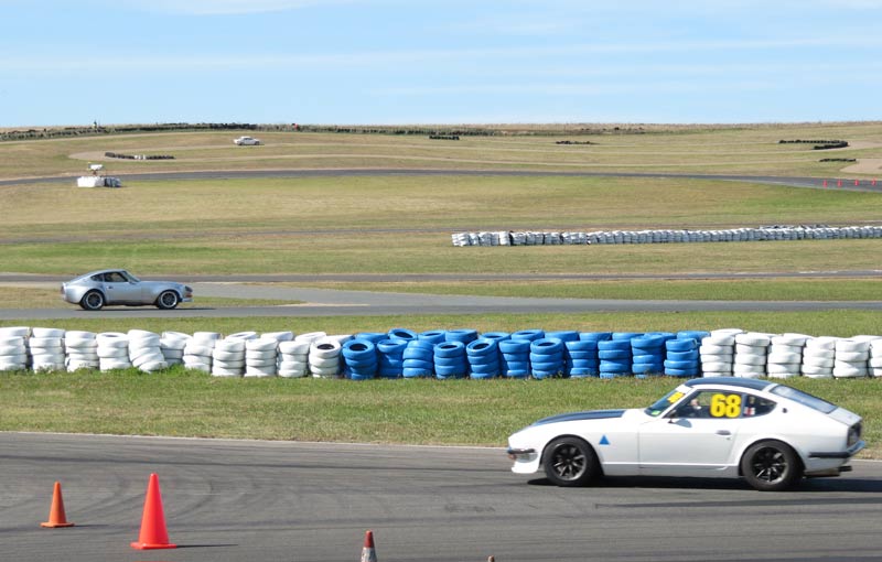

  11. Yeah I just got them for sprints. I just heard from Steve Cox that I won a trophy at Wakefield (I didn't stay for the trophy presentation as I had to return my trailer). Apparently I was quickest in type 2 (modified 3.0 to 3.5) which would be much more impressive if there was more than one other Zed in the class

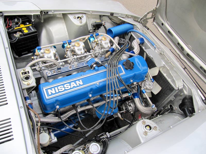

  20. I had a chat with Alan on the day. Actually it's still an L24 block but with 2.75 capacity and the Webers are 48DCOEs. Surprisingly it still runs points ignition and apart from plastic side windows all of the original steel panels and glass are still in place. To answer another post yes they were slicks, which never really got up to temperature on 4-lap sprints. The brakes are CL Valiant vented discs on the front, can't remember about the rears.

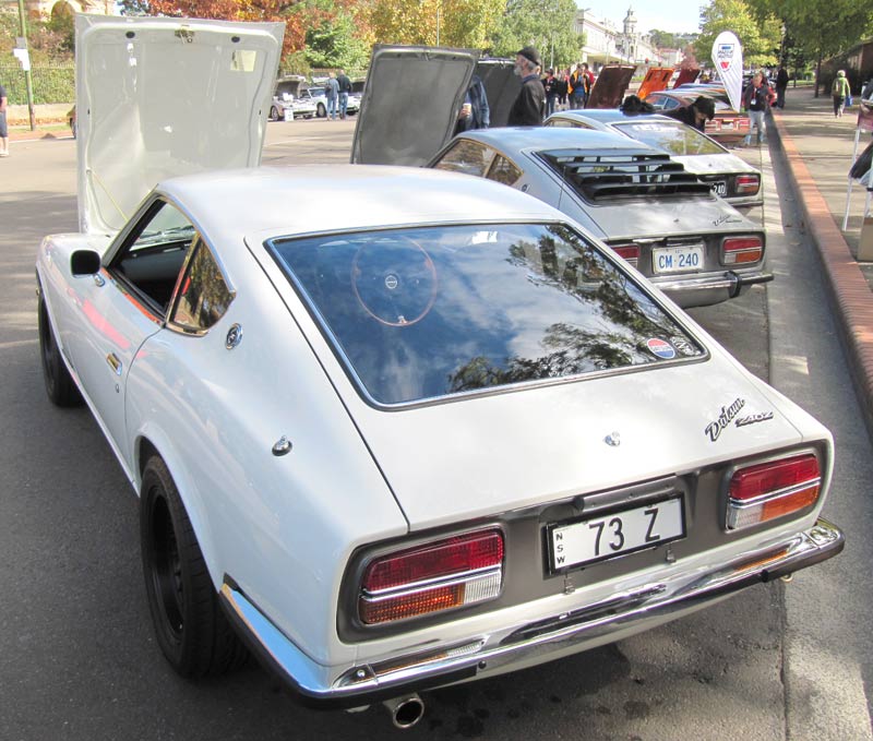

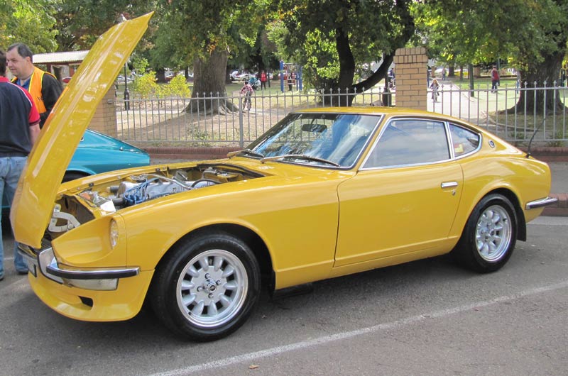

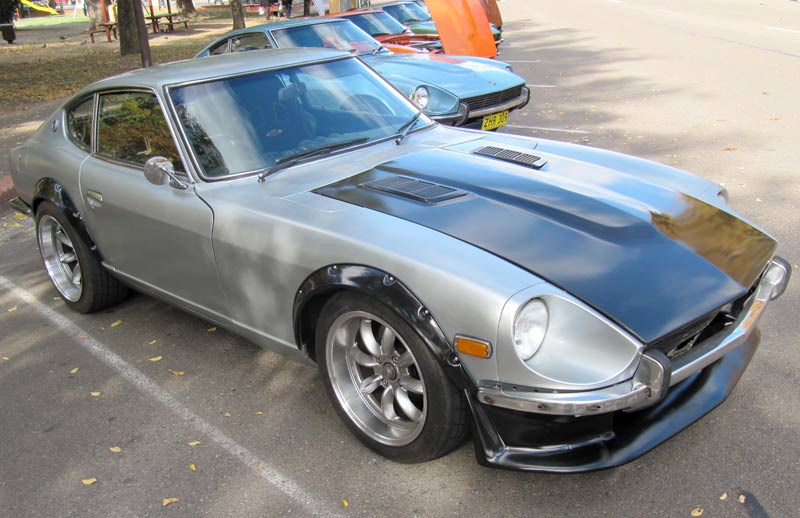

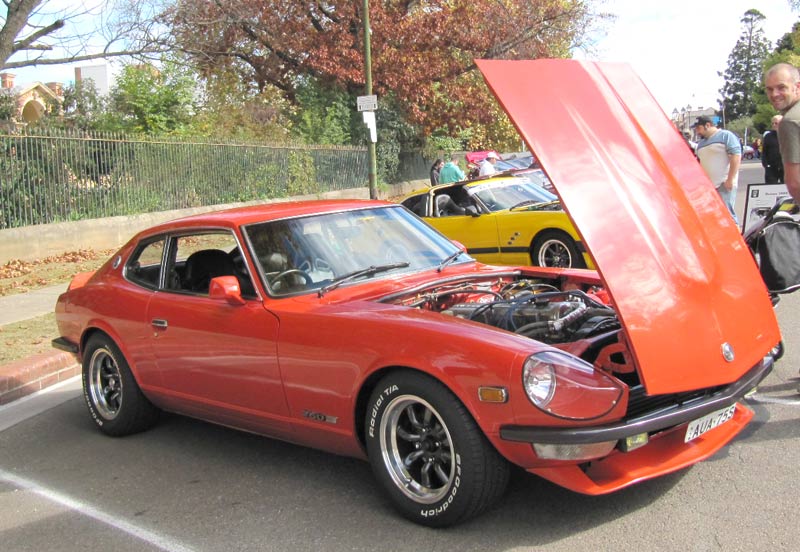

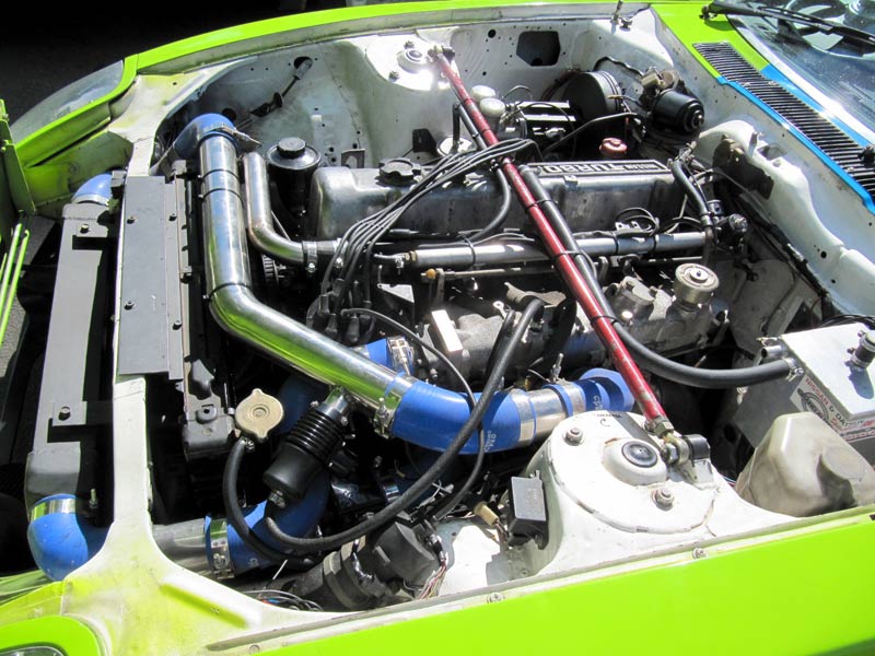

  22. Some more pics of the early Zeds at the show
