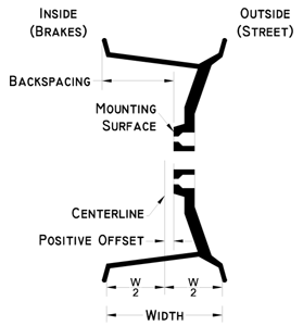

240Z & 260Z Wheel/Tyre Options, Offset, Backspace
RUSSJZ-ZED replied to Toecutter's topic in Wheels and Tyres
Another picture thats worth 1000 words,PCD number is the diameter of the circle in mm. PCD is pitch circle diameter, a PCD of 114.3(x4) is standard 240/260/280Z , 114.3 circle x 4 bolt holes. 114.3(x5) is same size circle, but with 5 bolt holes(this is PCD of Z32s, late Skylines, most Big Toyotas.) -
backspace of 115mm fits on front, with standard springs, gets tight after that, dont forget that the wheels have to turn, 17x8s with 235x45 were picking up the guard on lock, easy curable with angle grinder(this is assuming you are not on the concours team) Diagrams might help understand offset and backspace.

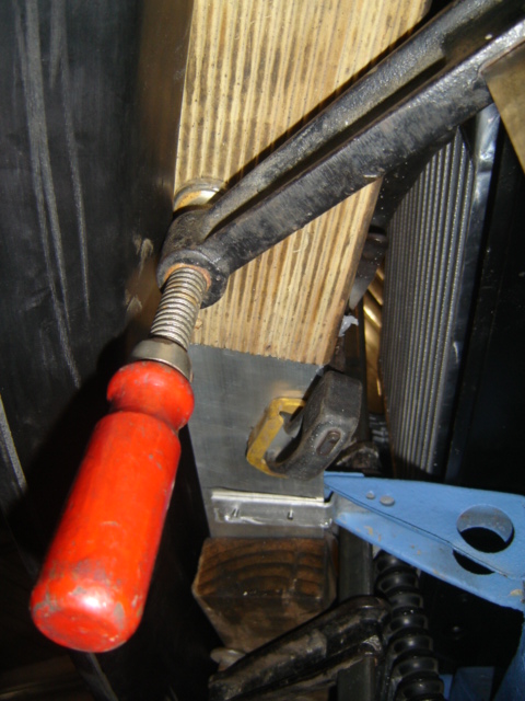

Fixing a Zenon urethane/poly/plastic front dam, People on hybridZ have experienced problems with these ,mainly the urethane/poly/plastic distorts at high speed. I bought one of Warren at Z spares a while back ,mainly because I think it looks the pick of aftermarket dams,blends in with the line of the guards,and the urethane would last longer on Sydney roads/lanes etc. Fibreglass would die in a day. :idea: Knowing about the flexing problem before I started I decided to mount it so it would have the strength to survive gutters, but also not wobble about at speed, This is what I did. The old front corner panels that are not supposed to be used, I used, got the angle grinder to them and cut them off about an inch below the securing bolt holes, across the top of the park/indicater light holes. I mounted the Zenon with the remaining strip of the corner panel behind it ,makes it more secure than just bolts and washers.better clamping(I didn't get pic's of this ,sorry) Across the center flat piece, I cut a piece of 75mm x 2mm aluminium, curved the ends so it fitted snug on the underside of the flat center poly,(pic's) roughed it up with the grinder. in the center I attached a "tag" that bolts to the center grill mount, buttered up the aluminium with silicone(lots) , pushed it into place, with pieces of 3x1 underneath, long piece on the top, used clamps, 3 or 4 of them(as many as you can fit) to squeeze the alluminium/silicone onto the polyurethane, left it for the weekend(best left as long as possible) removed clamps and 3X1, Result is ,strong as, does not flex, has enough "give" on the bottom lip to grind away, and survive the dips, speedbumps,and gutters of Sydney .town.
