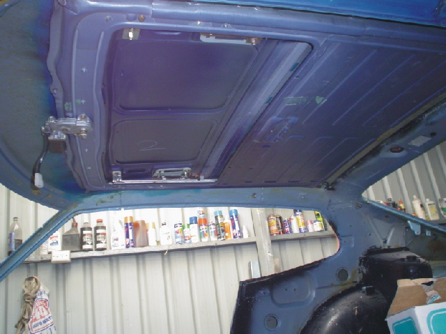

    RBZ260 Sunroof
    From the album: RBZ 260
    the car came with some crapy sunroof pop with 10kg of silicon around it so it doesn leak. didnt like the pop glass ones so went for a hunt and got my self a 1984 toyota celica/supra electric sunroof all metal. for $60 cant complain.few hrs with grinder and welder got it in.it actualy reinforced the roof cause it has a subframe under the original skin almost act like a roll cage and roof very solid. and yeah it goes in and out very nicely. looks lot better than that glass pop top.
