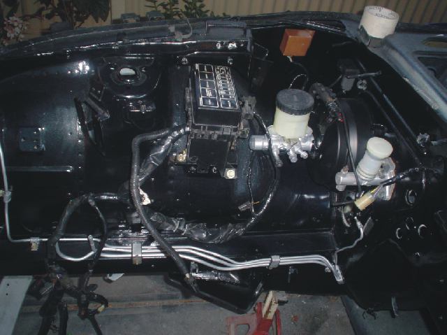

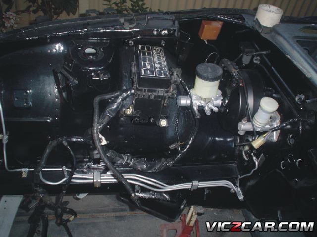

complete wiring from the half cut of a doner r32 was used. the old z is somewhere hiding in dump boxes now.
complete engine and all accesories were fitted prior to the paint and then all removed. so all extra brackets added and extra holes or nuts were welded in for that factory look.also all unecessary old stuff was deleted. also master cylinder and booster is r32 item as well as clutch master cylinder.. fuse box and relay box reside neatly with custom made bracket. also r32 radiator and big intercooler.
