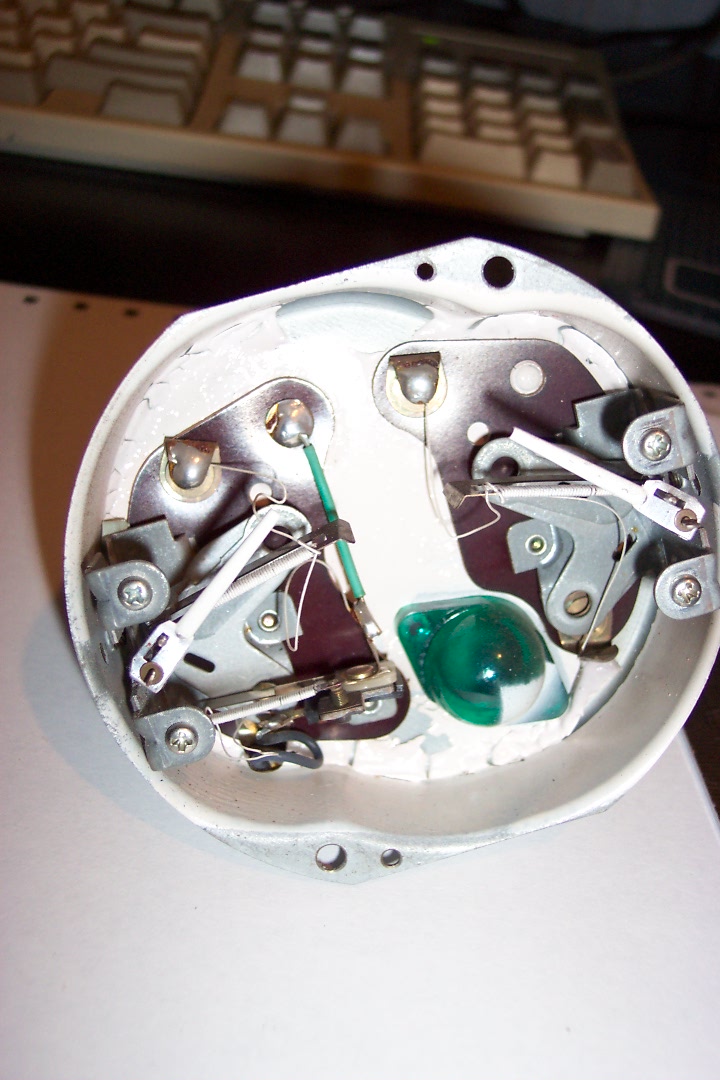

The gauges have a green globe cover inside the guage, which gives the gauges the green colour, you will have to remove them if you want white leds. And you'll need to use the really bright ones, but you probably know that.
Heres the inside of the temp/oil gauge, showing the cover.
