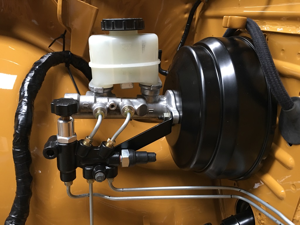

twoforty z Posted July 22, 2017 Posted July 22, 2017 Hey ladies and gents, About to undertake this mod, picked up my r33 booster yeaterday. My question is, judging by pictures posted you dont need to retain the proportional valve, but can you still use it? Means i can still use the brake warning light wiring and fewer/shorter hard lines need to be made/modified. Quote
KatoKid Posted July 23, 2017 Author Posted July 23, 2017 You can retain the valve (its a pressure differential, not proportioning valve) and still use the original brake warning light wiring. Or you can ditch the valve and just use the float level switch in the master cylinder reservoir. I wanted to use an adjustable proportion valve in my set up and the engineer was fine with ditching the old valve and using the MC float switch in its place. The float switch just needs one earth and the other goes straight to the original single wire for the warning light. twoforty z 1 Quote

KatoKid Posted December 10, 2017 Author Posted December 10, 2017 Should we sticky after confirmation there are no issues with installation and use? Just in case... Brilliant write up David; might have to do it when all the zed boosters are dead and buried. Unfortunately Dmitri isn't active here anymore but I can confirm 100% that this booster/master combination works very well with upgraded calipers. Really powerful, optimum pedal stroke and easy to modulate. Big tick from me! Quote
