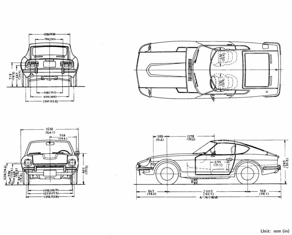

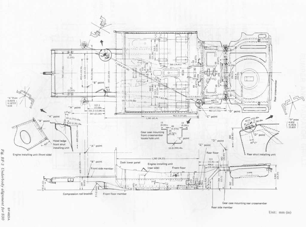

I am working on the front end of my 240z and it has clearly taken a bit of a knock at some stage. It seems to be pretty square to me, but does anyone have the dimesnions for the bay and where I should take measurements to make sure everything is in alignment.

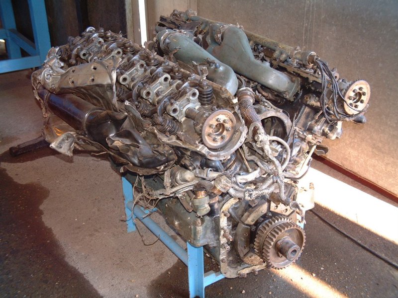

Hope this helps and you can fit one of these!
You may have to save it and then enlarge it.  It's the biggest one I could find
You trying to tell us something with that Merlin picture Simon? Maybe a hint for the conversion youre planning!
Yep pic 1 and 3 are exactly what I am looking for... but even downloaded and enlarged I can't see the numbers... anyone got a higher res scan??
The Merlin would seem to fit rather nicely... want to bring it around for a trial fit to my car ?? (-;
