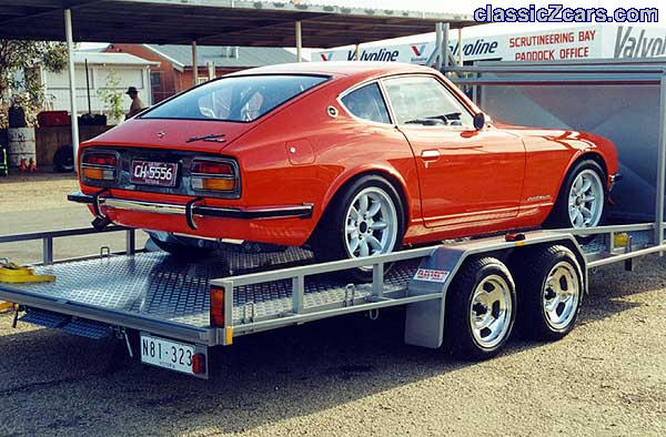

mouse240z Posted June 23, 2007 Posted June 23, 2007 hi all, can anyone tell me, does the the car in this picture have 16" wheels or 15" and are there any problems with running 16" panasports on 240z's. Cheers Kevin. Quote
sco_aus Posted June 23, 2007 Posted June 23, 2007 Yeh 16's to me too. It all depends on the offset and width. 16'2 tend to fit pretty well in zeds, but there too many variables that we dont know, so let us know more about the wheel and we can help. Quote
zedevan Posted June 23, 2007 Posted June 23, 2007 the wheels in the pic look more like performance superlites, and is probably more likely since the car is in australia? panasports cost heaps over here rota have released their version of these wheels in 17" which might look quite sexy, i think they are a bit under US$700 for a set. Quote

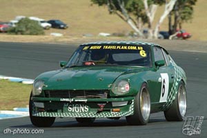

NZeder Posted June 29, 2007 Posted June 29, 2007 Here is a pic of a 260z (well actually a Fairlady Z ie was L20aE power now L28e powered) and it has the performance 16x7 rims on it. So I think the photo of the orange 240z is Panasports before performance released the 16 as that photo is not new I recall seeing it on another zed site about 3/4 years ago and I don't think performance wheels had the 16's then. Quote

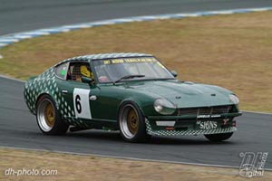

NZeder Posted July 1, 2007 Posted July 1, 2007 The ZG flares should cover a 10" wheel as the Japanese homologated 10" wheels for racing, and only one type of wheel flare. I will have a look at the documents tomorrow at work and see if they show the actual offsets and backspace measurements of the wheels. Now don't forget that Nissan Japan did homologate two type of ZG Flares the standard ones you see every and that were fitted to the HS30-H (ie real ZG road cars) and the ZG Overfenders known as the B flares there were much much wider and can be seen on the Nismo S30 see here for a pic. Quote
Toecutter Posted July 1, 2007 Posted July 1, 2007 This pic shows standard ZG flares on a 16x10 (I think -26 offset) wheel made by the same company Performance wheels. It's hard to see in this pic but they did stick out past the flare lip by about 10mm. Quote
