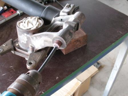

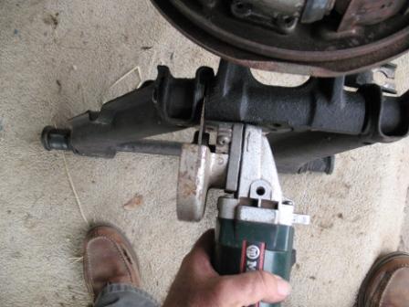

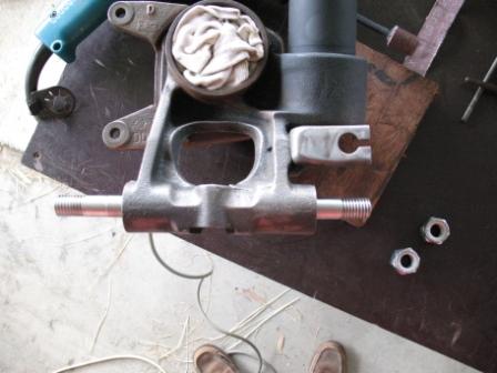

When you have to get serious. Cut it.
1. Take out the assembly.
2. Cut the pin and knock out the end stubs. Careful to only cut the pin. Take your time.
3. Ream / polish the bore. If you don't have a reamer, make your own polisher. Do not oversize the bore.
4. Check fit of new pin. Use anti sieze. Do not use force to fit the new pin. Careful to align the lock pin slot.
5. Assemble. Do not over tighten threads. Check torque settings.
