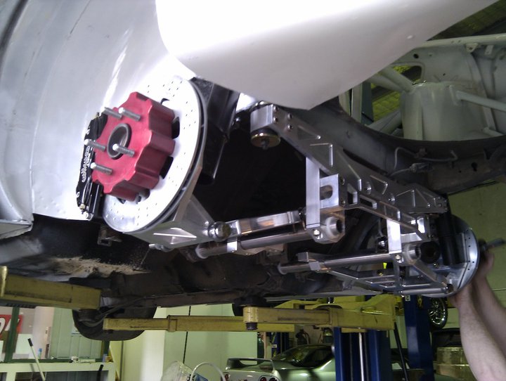

well you don't have to mod the front to get that wheel in ,,,, and the strut on the rear stops you tubing inwards , so it has to go out  if you wont big wheels  .

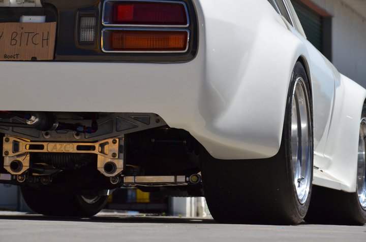

the rear are 13 by 17 , made in melb by harry  in serento . the wheel tub is flat and has been welded fully and the flear is from alfa fiberglass ,,,, lots of work as there still to small for the job , but next week is getting all new body bigger all round
