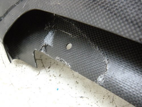

Looking for advice on potentially repairing a used intake that is cracked / damaged.

I'm not sure if it's genuine carbon or fiberglass overlaid with carbon? I've previously repaired a fiberglass front bumper / air dam on a 260z and from memory it was very easy to do. Carbon I know nothing about.

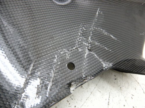

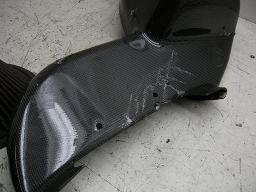

Problem is with repairing the carbon that the woven fabric would be difficult to join and visually seeing that it had been repaired. Unless your not concerned about the carbon fibre look (which we all think is reallly cool) and paint the product after repair. Other than that it is just fabric and resin!
Im going to assume its not structural, afterall its just an air intake.
It also looks like the damage is on the underside of the intake.
If thats the case, most of it wont be visible.
So, you should be able to sand back the gel coat till you hit the fibres, then lay another layer of mat over it, then resin it all together.
For the bit where it'll be visible in the inside of the intake mouth, cover it in resin to fill the cracks and imperfections, then sand smooth.
That should blend most of it in.
That should also work quite well on the backside cracks and chips.
You could allways paint the inner surface of the intake in a matt black, it wouldnt look out of place.
It looks like the upper surface (the bit that'll be most visible) will look just fine.
If you want to keep the carbon weave visible, you'll never hide it completely.
I say do it, what have you got to lose? a bit of your time?
