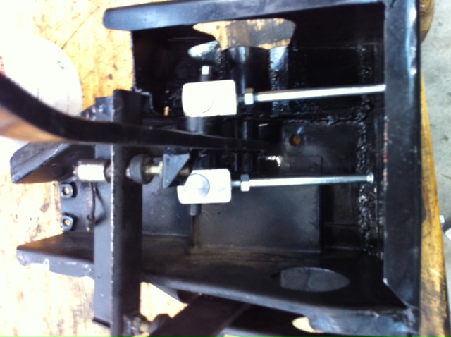

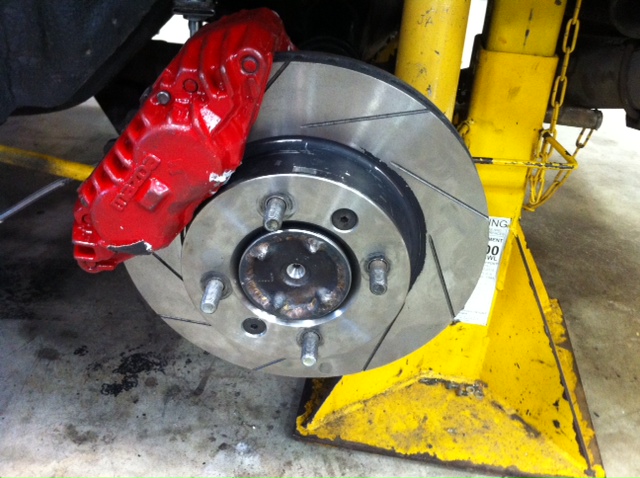

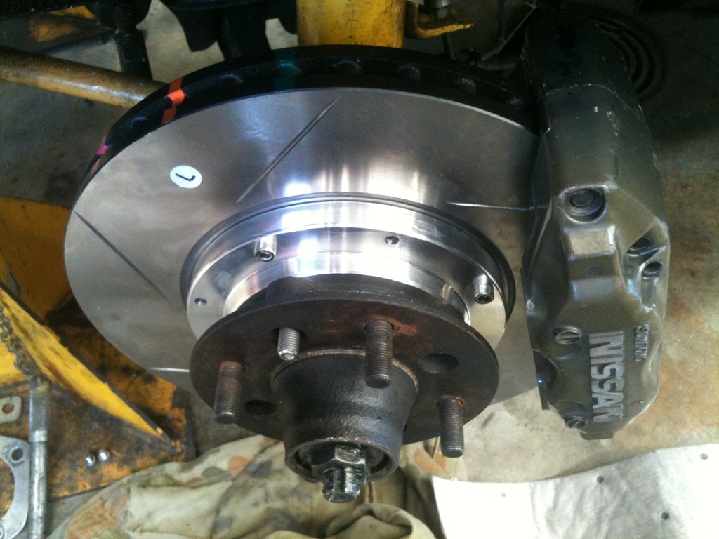

MJC Posted March 2, 2012 Author Posted March 2, 2012 The team have just completed a brake upgrade, prob worth around the 10k mark when you take into account machining parts and labour. Its a direct pressure system with a mechanical Bias, Front brakes are DBA 2 piece S5000 Vented and Slotted R33 Skyline Rotors with matching Caliper. Rear are a RX7 Caliper on a DBA vented and slotted Rotor. Quote
Moderators Zedman240® Posted March 3, 2012 Moderators Posted March 3, 2012 Looks like a excellent setup! That disc look real meaty in that pic. Similar to a setup I have. With luck it shouldn't glow red when driven hard! Quote
