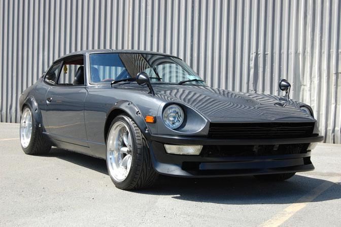

Administrators gav240z Posted January 12, 2012 Administrators Posted January 12, 2012 BTW: Jay's car the dark grey 2+2 you posted a picture of has S2000 seats in it. Quote
