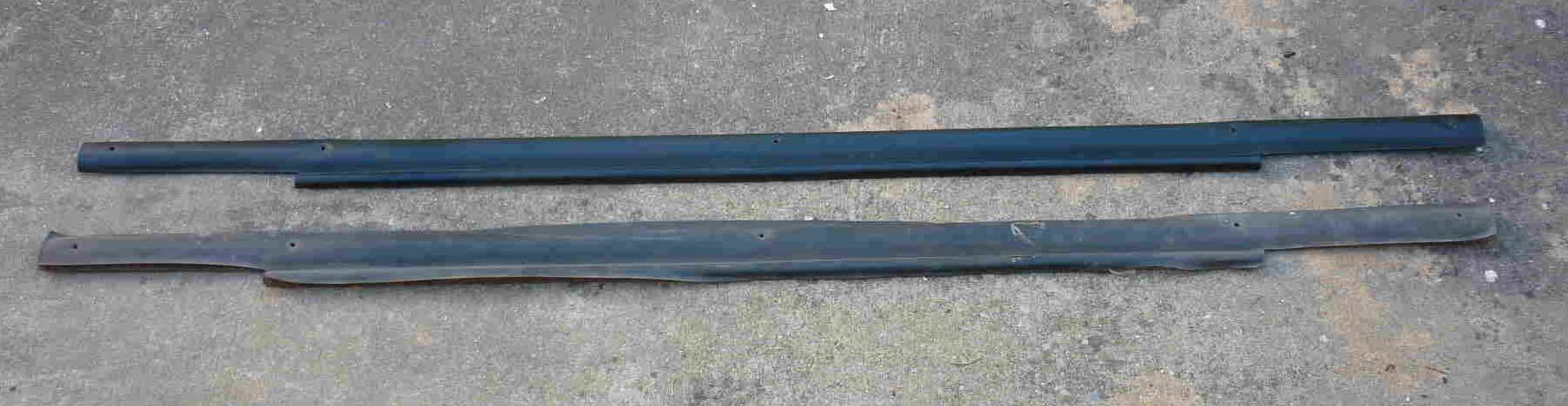

fluegel Posted February 3, 2012 Author Posted February 3, 2012 I ended up regluing the plastic covering back with super glue, they look allright I removed the glue which got on the vinyl with acetone , removed the dirt as well. Lastly I gave them a wipe over with linseed oil and painted the rusty one inside with hammerite. Quote
fluegel Posted February 3, 2012 Author Posted February 3, 2012 Here is a pic of the plates , one is restored. Quote
