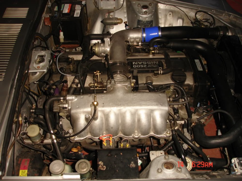

Found an older picture, but it shows how far back the engine is mounted, it leaves a lot of room infront of the engine and i mean a lot :P
The wiring and all the piping was a bit messy but you should be able to tell how far back it is, im doing a four point weigh when the engine is back in (to get the right spring rate) and ill let everyone know what balance ratio it has given me.
looks good to me. how much is a manifold so the air doesn't run over the top of hte engine?

No not at all, remember these engine mounts were made for the RB20 onto this chassis, they wouldnt have released it if it wasnt safe and although the 25 is a different engine and I do have a lot more power than stock, it was over engineered (if theres such a thing) and I havent had a problem at all and have checked the mounts and chassis area of it all and there isnt a problem.
