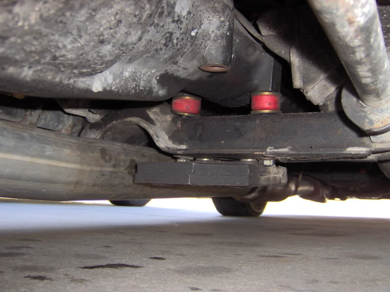

Riceburner Posted November 27, 2011 Posted November 27, 2011 I'm thinking of changing out my solid diff mount on my r180, I've heard they are great in racing cause the stop all movement in the front of the diff. Problems i have is It transmits a lot of noise, I have rounded off the retaining nut (it tightend in position), and I've also heard they can break . I have used rubber originals with the factory strap, with this setup and an R200 I broke 2 new nissan rubber mounts very quickly..... What do guys with big horsepower run..... ron tyler top mount and stiffer OEM mount like Kameari? I've also seen this setup pictured below, it's looks like it could work pretty well but it may still be noisey...... What do you think? Quote
Moderators Zedman240® Posted November 27, 2011 Moderators Posted November 27, 2011 I can agree with you about noise with a solid mount; its all I can hear in the back of my 240! With that mount you have pictured, if the bolt just goes through with the nolothane sandwiched there, it will still transmit some noise through to the chassis. I'll have to take a pic of my diff mount on the top once its on a hoist again. Quote

Riceburner Posted December 4, 2011 Author Posted December 4, 2011 Thanks for the suggestions guys. I've run the standard strap and it was tight but streched over time until the rubber mount let go, I even tried heavy duty chain and that snapped too, destroying my hanbrake bracket in the process... Boy did that scare the sh$t out of me. Managed to drive home like a pensioner with it completely broken I did have the original moustache bar rubbers in until recently, maybe these were allowing extra movement. I also run solid offset control arm bushes which probably add more noise. I have now fitted urethane bushes in the moustache bar, and will probably go with the technoversions top mount and a kameari lower mount. Quote
