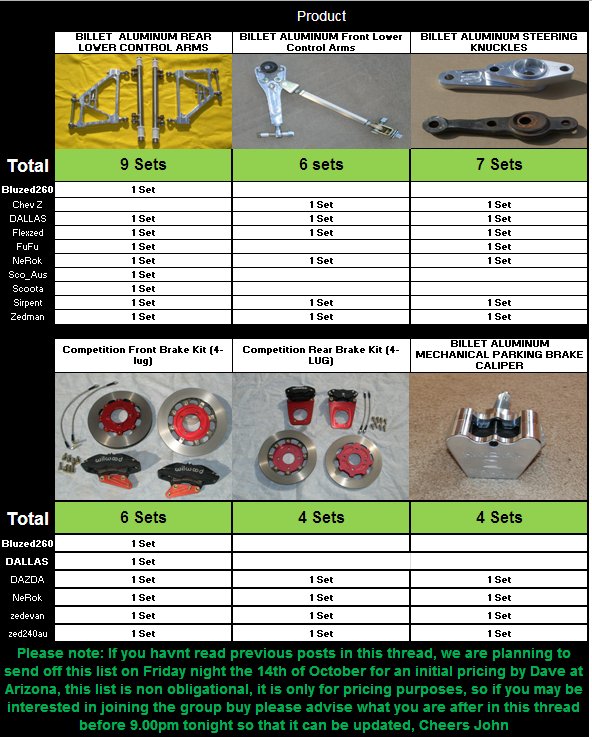

Sirpent Posted October 14, 2011 Author Posted October 14, 2011 Heads up, I have emailed Dave at Arizona with the numbers and also instructions on what we are looking for, I will update this thread once I get a response, for obvious reasons however, I will not be posting all financial details in this thread, I will however communicate via PM with the listed members as to confidential details and also to those that may still be interested post Dave's reply. Cheers John Quote
Sirpent Posted October 16, 2011 Author Posted October 16, 2011 Update. Thanks to Dallas for also jumping on board, your request was emailed to Dave Also just got this via email back from Dave List received! I'm up to my eyeballs with orders at the moment, as soon as I get caught up in a couple of days I'll get back with you with prices and shipping cost. Please thank the whole OZZY gang for their interest in my products ! Best regards, Dave P.S. anyone into bikes over there? My wife want me to get rid of "The Scooter" See attached pics, has 300 horsepower and will cruise at 225 MPH. Quote

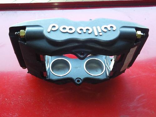

benny Posted October 16, 2011 Posted October 16, 2011 Sorry for not being clear John, I'm interested in the entire brake setup, but if it can't be engineered I don't really see the point, so only put me down as a maybe - what path are you taking for brakes and suspension? correct me if im wrong but I believe the wilwoods dont have dust seals which are a requirement for RWC/engineering?? Quote

benny Posted October 16, 2011 Posted October 16, 2011 LOL Benny I think people would retro fit them after certification. definitely... I know i would, but if you get defected it would be a huge pain!! They may not be an issue with dust seals just thought there was Quote
MaygZ Posted October 16, 2011 Posted October 16, 2011 I might be wrong my young father, but I think the dust shield thing is a furfy. Quote
neRok Posted October 16, 2011 Posted October 16, 2011 I might be wrong my young father, but I think the dust shield thing is a furfy.unfortunately not. http://www.infrastructure.gov.au/roads/vehicle_regulation/bulletin/pdf/NCOP5_Section_LG_Brakes_V2_01Jan2011.pdf page 9, last sentence of section 2.7.2 : "Caliper pistons must be fitted with dust seals." Quote
zedevan Posted October 17, 2011 Posted October 17, 2011 but if you get defected it would be a huge pain!! They may not be an issue with dust seals just thought there was the other pain with using wilwoods should they not pass engineers, is that any decent engine mods will require a brake upgrade, thereby meaning you need a decent "engineered" set aswell - although some vented two pot calipers would prob do the job, but then why not just stick with them. I've read something saying the wilwoods used by arizona z car do have a seal in them, they just dont call it a 'dust seal', not sure if this is true or if a certifying engineer could/would agree... might be best off to buy all their suspension gear and swap it in/out in one hit when defected Quote
benny Posted October 17, 2011 Posted October 17, 2011 unfortunately not. http://www.infrastructure.gov.au/roads/vehicle_regulation/bulletin/pdf/NCOP5_Section_LG_Brakes_V2_01Jan2011.pdf page 9, last sentence of section 2.7.2 : "Caliper pistons must be fitted with dust seals." eeek now Maygz is going to Defect us all ??? Anyway sorry for thread hijacking!! Quote
handsandwhich Posted October 17, 2011 Posted October 17, 2011 How hard would it be to just make up a little rubber gasket that seals around the pistons? Quote
sexual_sushi Posted October 17, 2011 Posted October 17, 2011 Apparently wilwood offers dust seals on some of their calipers now, perhaps it's worth asking the question of Dave? Quote
benny Posted October 17, 2011 Posted October 17, 2011 here is the listing for calipers that have"dust boots/seals" http://www.wilwood.com/Calipers/CaliperList.aspx?appl=&subname=&dustboot=Yes&numofpist=&mtspec=&pistarea= Quote
zedevan Posted October 18, 2011 Posted October 18, 2011 If it's possible for a wilwood brake setup to pass engineers, my interest/commitment goes to 100% - not sure if others feel the same way? Quote
