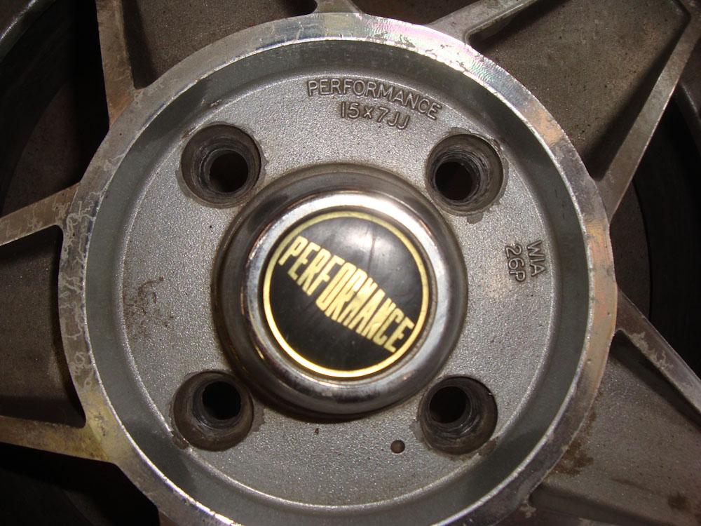

I'm looking for wheel nuts to suit Performance Challenger wheels for my 240. Not sure if different wheels have different taper for wheel nuts? Any ideas?
If anyone has some to suit please let me know.
Also, any idea what the WIA 26P cast in to the wheel means? I was thinking it might have something to do with offset or similar.

Pretty sure the thread on the wheel studs are 12mm x 1.25mm (mine is!).
You can probably buy wheel nuts off the shelf to fit, but I'd suggest measuring the size you want by shoving a socket into them to find out what fits best! At least that way you will be certain you can put them in when you get them. (Some mags will needs quite thin wheel nuts!)
Also note the surface that the nuts will be seated on, it may be flat or it may be on a 45 degree angle, both are reasonably common. You can pickup wheel nuts of varying sized, shapes, designs and colours at most auto- shops (supercheap, bursons, auto-pro, etc. They are also plenty on ebay if you're feeling lazy and patient).
Not sure about the casting on those wheels tho :(

Tapered wheel nuts for Performance wheels (12mm x 1.25)  can be sourced through any auto parts shop (Bursons etc)
I bought some recently off the shelf from Bursons, a pack of 4 was around $10
