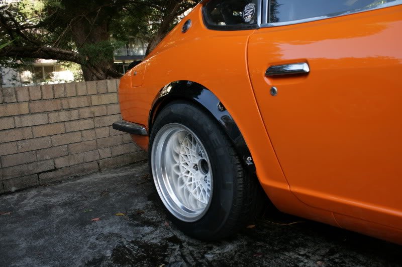

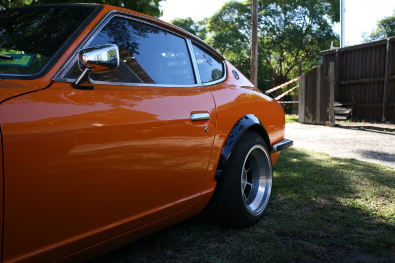

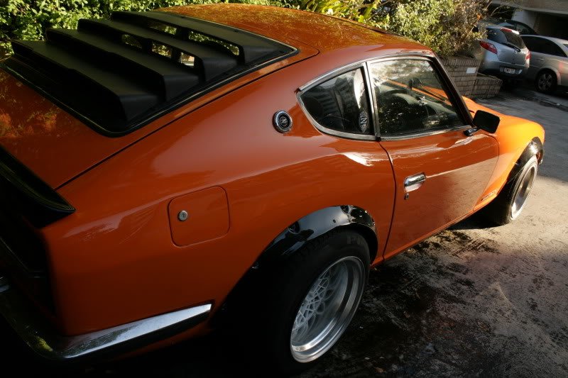

aidannn Posted May 8, 2011 Posted May 8, 2011 i have 15x9.5 -19s on the front of my z. def. need flares to cover them. tire size makes a big difference with fitment. im running a 195/55/15. Quote
Roberto Posted May 9, 2011 Posted May 9, 2011 195's on a 9.5" rim? Whoa, that is a massive stretch! Can you take a pic for us? Quote
aidannn Posted May 10, 2011 Posted May 10, 2011 Hayashi Street 9.5" -19 195/55/15 SSR Formula Mesh 9.5" -33 205/60/15 i much prefer the 205/60, less stretch fatter tyre. having said that id rather have no stretch than stretch. ps. rear scrubs alot. guards are rolled. king springs. getting them cut up at welded soon to fix it. Quote
NZeder Posted May 10, 2011 Posted May 10, 2011 shame you can't get a 245/50/15 anymore - that would be perfect for a 15x9 and a little stretch for a 9.5. Great looking car aidannn Quote
