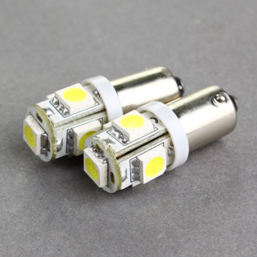

As part of my ongoing upgrade of the dash and instrumentation, I have been searching for LED replacements for the standard BA9 globes found in our Zed's
After a fair bit of searching I have found these, they are direct replacement for our standard bulb's, plug and play and come in the following colors
Amber
Green
Blue
Red
White
These provides a 180 degree wide dispersion with 1 cluster at the top firing forward and 4 clusters firing radially.
240Z / 260Z dash assy's require 15 BA9 bulbs as follows
    Speedometer Illumination = 2
    High Beam Indicator (In Speedometer) = 1
    Brake Warning Indicator (In Speedometer) = 1
    Tachometer Illumination = 2
    Left Turn Indicator (In Tachometer) = 1
    Right Turn Indicator (In Tachometer) = 1
    Amps (or Volts) / Fuel Level Gauge = 2
    Oil Pressure / Water Temperature Gauge = 2
    Clock Illumination = 1
    Glove Box = 1
Price delivered for a pack of (X15) delivered to your door after I receive them and re-mail them to you would be about $70.00
Please get back to me if interested with your preferred colors as I intend ordering mine in the next few weeks an am looking at putting a group order together for 10 sets as a minimum.

To stay stock i think you'd need white as the filter provides the green light.
Looking forward to seeing how these look.
Either way will work; green light going through a green filter will give you green light....
