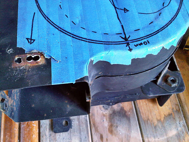

OK, so the vid on Youtube speaks a 1000 words, however the following are the sequence of modifications that had to be undertaken to get to that point.
The problem I was alluding too previously is that the placement of the VT Blower in the Zed housing was easy, however the VT blower rotates in the opposite direction to the original Zed motor, reversing polarity wouldn't work either as the Squirrel cage fins were designed to rotate in the direction of the motor.
Therefore in order to actually get the set up to work, the entire enclosure had to be reversed, the side of the enclosure where the motor originally bolted to now had to become the inlet side facing the plenum intake while that side had to become the motor mounting side, this meant that 3 brackets needed to be removed and reset on their opposite facing side.
You will all probably think now that this is a hell of a lot of work, it isn't really and I found that I knocked it over very quickly, the hardest parts to doing this mod where actually drilling out the factory spot welds and cutting out the motor recess in the enclosure.

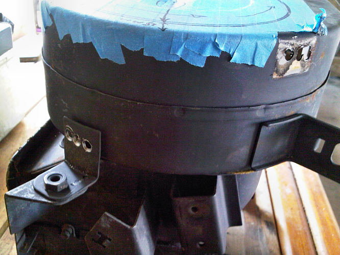

Blower pic #8 shows one of the brackets I have predrilled the spot welds to indicate where they are.
Blower pic #9 shows where the bracket was and where it would end up sitting in its new position as seen in the bottom right of the pic.
Blower pic #10 shows the second bracket also predrilled in its original position.
Blower pic #11 shows the repositioned bracket now in the bottom left of the pic.
These are the new mounting positions for the enclosure.

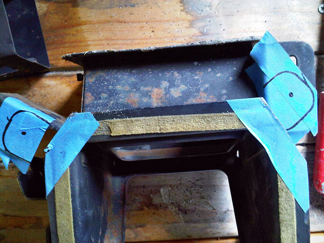

In order to position these mounts in their new correct positions so allowing them to use the original mounting nuts of the plenum intake, I had to nip away 2 small corners as seen by the blue tape.
Pic #12 shows the required cut lines along the tape line.
Pic #13 shows these corners cut away and the remnants sitting on the tape.
Pic #14 shows where the new brackets would now sit after I mounted the enclosure in place and market the hole positions for the mounting bolts.

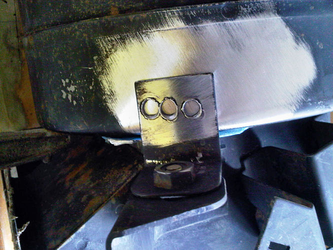

Pic #15 I drilled these holes, then placed the enclosure on the intake, cleaned the paint off the weld sections and then bolted the brackets in place, using the drilled out spots I then welded the brackets into position.
Pic #16 in this series shows the welded brackets in place and the 2 sections bolted together.

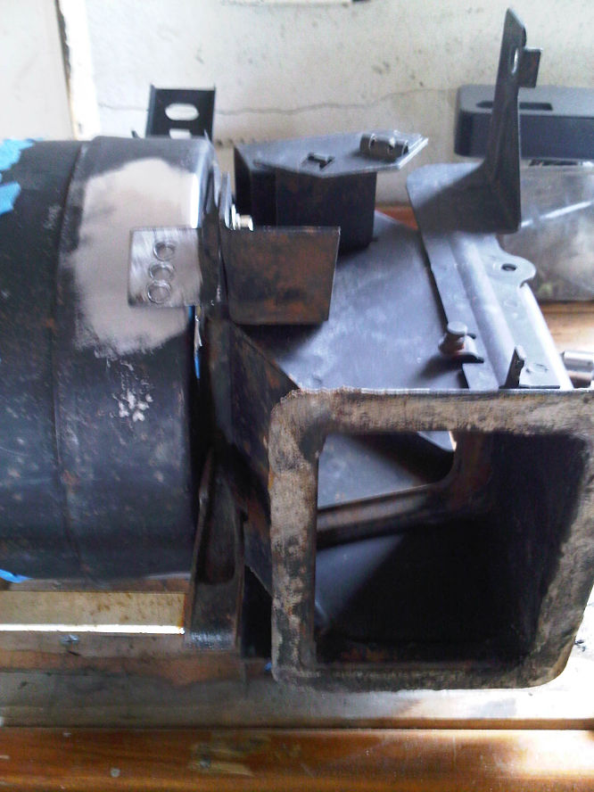

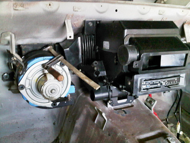

Pic #17 shows the new unit now trial bolted to the inside of the car, I used a clamp to hold the new blower less the squirrel cage in place to see how everything lined up, so far so good.

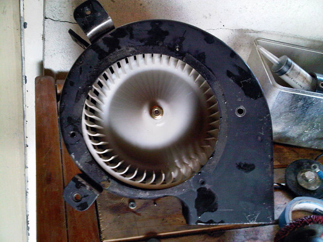

Pic #18 shows the now cut away section of the new motor side, I used a angle grinder to do this and then having left a few mm's of meat used a flapper on a drill to camfer the edges until the motor and squirrel cage seated properly in position.
Pic #19 now shows the assy in place within the enclosure, I was extremely happy with how it all came together, the flow dynamics of the positioning promised that I should see or rather feel an extremely good flow of air due to the tight fit and subsequent compression of incoming air.

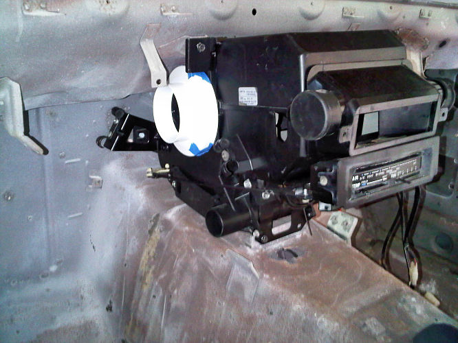

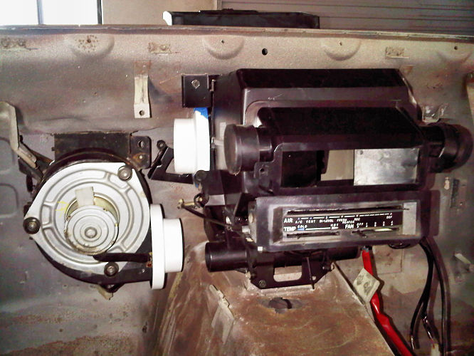

Ok so we now all realise that in order to do this retrofit you need to basically turn the enclosure upside down, for myself I'm happy to do and go throughthis as the end result is I will have a far better system with the air-con and since the car is stripped down it's accommodating to do so.
However in saying that the problem now lays with how to connect the blower outlet to the heater / air con box ? as usual its amazing what kind of inspiration you can get by just going down to Bunnings, i wanted to obtain off the shelf items anyone here could access in order to achieve the best result and write up a valid tutorial.

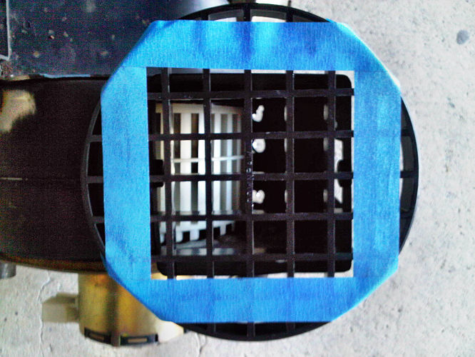

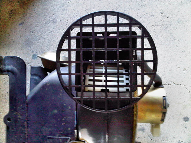

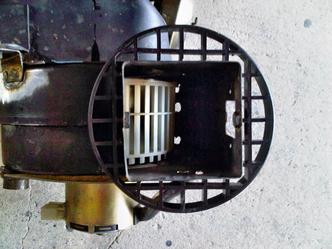

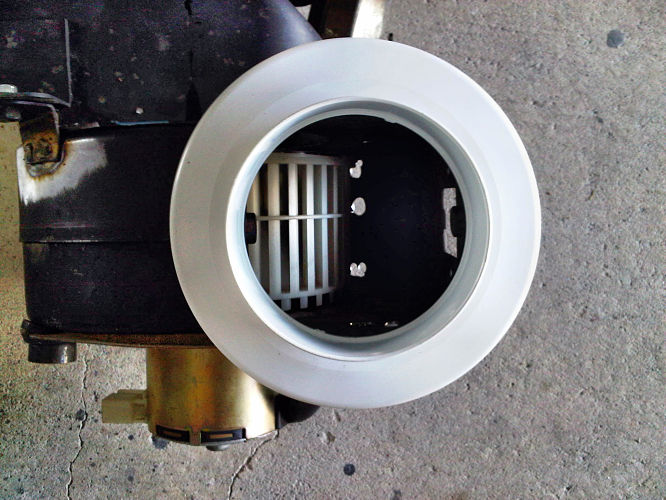

Pic #24 Walking around with the factory connector I came across these in plumbing, they are drainage traps that sit below common taps embedded in the concrete.
Pic #25 They come in 2 pieces, the removable matrix and the main body, some quick brainstorming and $13.00 later it was back to the snake pit and start modifying, here you can see the matrix sitting over the exhaust port of the blower enclosure.

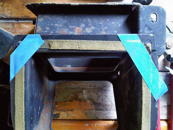

Pic # 26 shows the cut out requirement as outlined by the blue tape.
Pic #27 Using some tin snips I cut each brace away, the fit was nice and tight, I will later urethane this in place and plug up the outer cavities with urethane also.
Pic # 28 shows the shaft section fitted over the matrix, although the matrix will be urethaned in position, I will use 3 self tappers to secure the shaft section to the matrix in final assy, the fit is tight so no sealent material will be required.

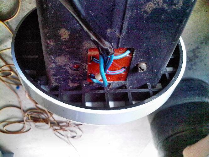

Pics #29 and #30 show the heater resistor in place sitting in its original factory position.

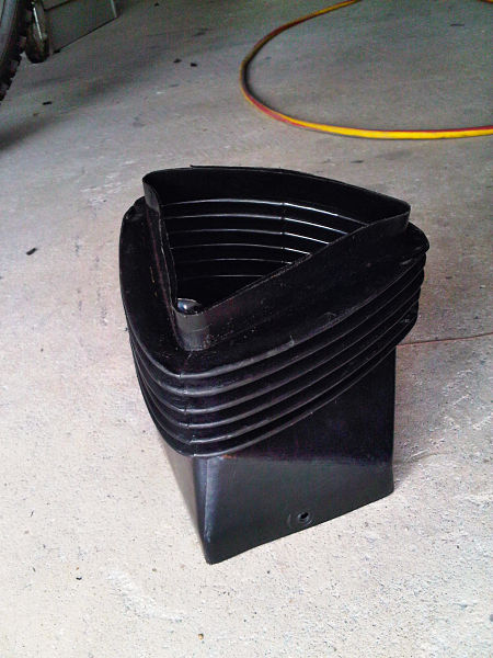

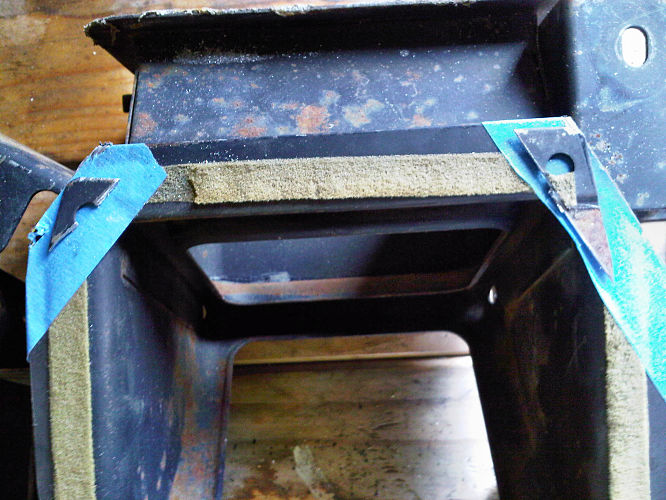

Pic # 31 This is the factory connector between the enclosure and heater box, the next item to tackle.

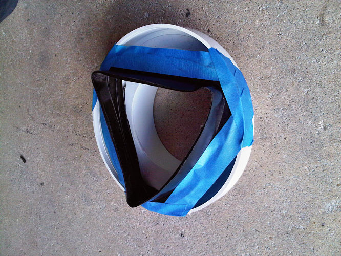

Pic #32 I cut the connector in 2, the triangular side slips into the inlet side of the heater box and basically sits there, the other end which progresses into a square union that had previously connected to blower enclosure was discarded, I have taped it in place for the moment, but this also will be permanently fastened in place using urethane.
Pic #33 shows this item now in position in the heater intake.
Pic #34 here both units and the new flanges in place and their relevance to one and other in the mod, I will be fabricating the connector manifold in the next day or so.

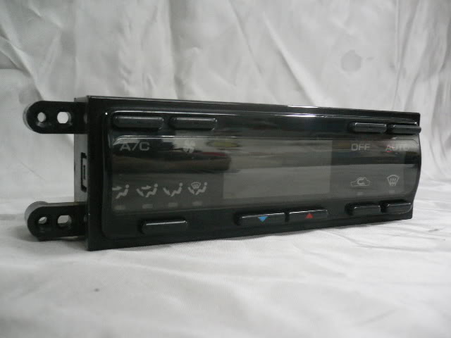

Was reading Johnny RBZ's upgrade to full electronic climate control today and gave me an idea, so I'm looking at retro fitting a 180SX unit as pictured with full actuators replacing the vacuum system.
