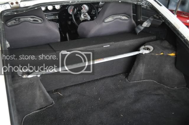

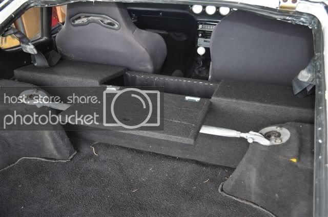

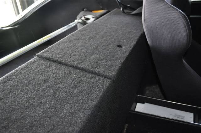

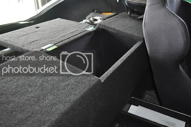

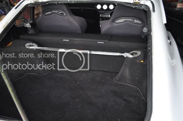

I’ve really been enjoying the sound of my engine whilst driving in the Zed but having no stereo at all is getting to me. Part of the installing process obviously involves finding a spot for the speakers. I discussed this issue with my brother who decided he would make up a custom speaker/sub box that would go behind the seats between the strut towers. The speakers would sit behind each seat and there would be a storage compartment in the middle.
He finished it today and brought it round. I think it looks awesome. Now I just need to get some speakers and a head deck.
What do you think of it?
cheers

Couple of questions, why did it need to be so tall? If it were shorter, your seats could recline that little bit further back and you would still be able to reach over it and get stuff that is sitting in the boot. Also it wouldn't stand out so much.

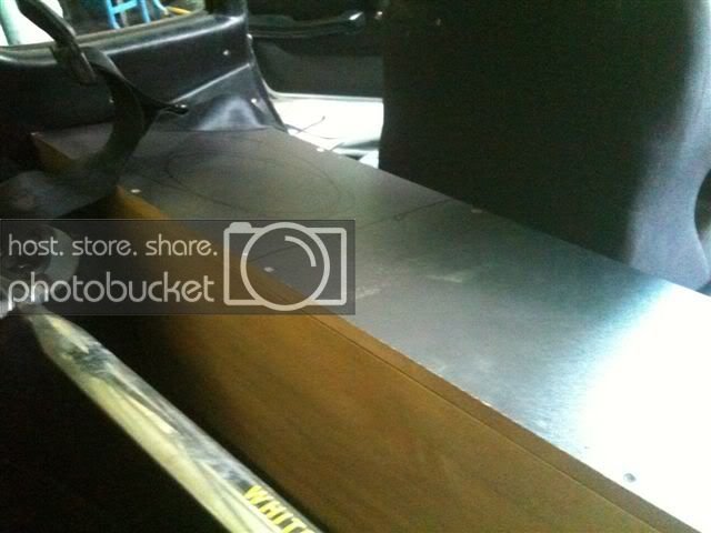

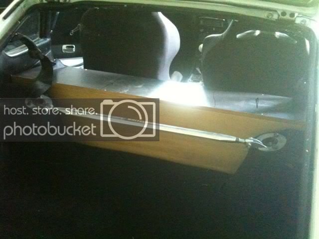

thats very similar to the one i knocked up for my zed when i was actually driving it (many moons ago :-[) Mine was just tall enough to fit a 10" sub in it in the centre between the seats and had the speakers mounted on the side just below the quarter windows, over the wheel arches.
the amplifier was mounted on the face, just behind the drivers seat.
The top edge of the box was the same height as the rear strut tops, so it'd just clear under a strut brace that i was planning to make.
The leading lower edge of the box butted up against the factory metal lip behind the seats, so it stopped it from moving anywhere.
It was very good being able to move the seats right back, it really helpded with getting in and out of the car, particularly in tight parking spots.
If anything, the internal volume was too big for a single sub, i should have incorporated some storage space into it.
While it was quite nice at 'seperating' the cabin from the hatch, even at the lower height it was still a pain at times to reach over for things, necessitating actually having to get out and open the hatch.

Yeah this one is slanted to the front but since you mentioned it it could be a little lower height wise. There is a pretty decent storage area inside. You cant really reach the hatch compartment now but it does stop what ever is in the back rolling around or ending up in the cabin  when you brake hard. I have a fire extinguisher too which I was going to mount inside the box.

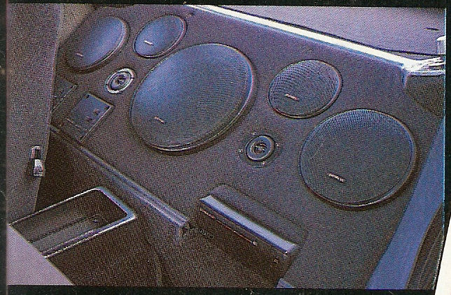

Here's a picture from 93 Street Machine Magazine with something similar.
