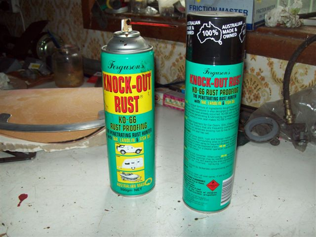

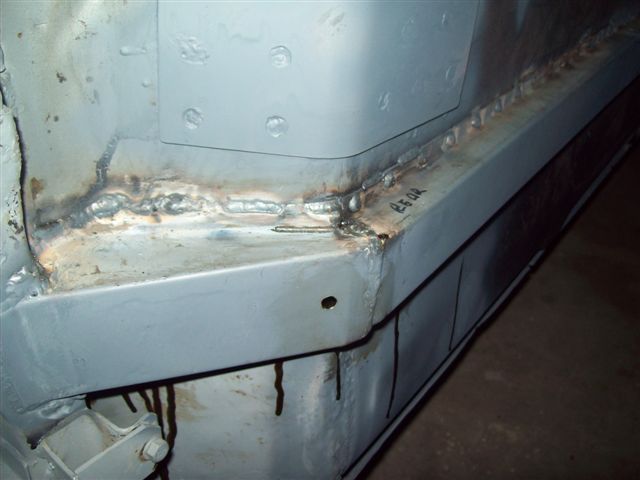

PeterAllen Posted January 2, 2011 Posted January 2, 2011 When I was welding the rails I was very keen to ensure they wouldn't rust again (too soon). I did a lot of research into rust inhibitors and weld-thru primers, etc, and in the end I threw everything at it. One product that gave me a bit of confidence was Ferguson's Knockout Rust. A good part was that it melted at welding temperatures but it did not disturb the welding process, i.e. you can weld right through it. Quote
