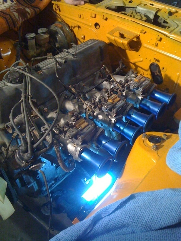

Whittie Posted December 23, 2010 Posted December 23, 2010 Hey All, Just started pulling the motor down as part of the rebuild and I'm looking at all aspects of it and I came across the interesting conundrem of Ram Tubes. The Ram Tubes on the car are SUPER long, and this would not normally be an issue, but I've put those cylindrical K&N type air filters that have the chrome plate on the ends. The ram tubes come within probably 1-2cm of the chrome plate and I can only assume that this is killing engine power. So, I was wondering what length people use on their motors, what effect the length has on the motor (from a fluid mechanics point, so long as it's smooth and well rounded I can't think of anything it would do). Also, if anyone knows somewhere reputable to buy them, the places in the UK want upwards of 20 pounds each plus shipping for these things!! The tubes will be inside the air filters so colour really doesn't matter, but if the cost is irrelevent, blue Cheers Quote

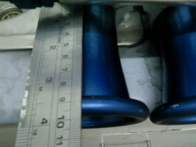

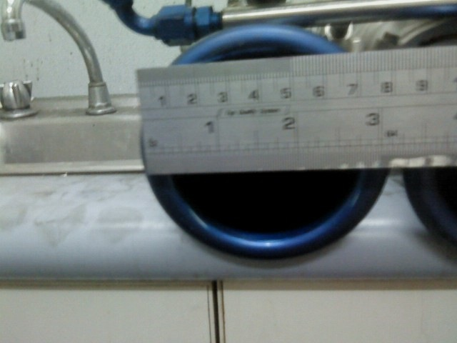

ChrisZ Posted December 31, 2010 Posted December 31, 2010 I did a fair bit of reading my self, when i had to figure out the air horns for my engine, i can't remember ½ of it, what i remember is: 25-30 millimeter from bell mouth to filter. Stacks like Ramflo should be best. Total length from head to bell mouth is the most important. And bla. bla. bla. I ended up in doing my own design based on collected information from the net. Full radius bell mouth, 50 m.m. bore at bell mouth, camfering in at 30 degrees for best airflow ect. these are for 40 Dels and the picture is of my proto type. This is from when the mounting ears wasn't milled out, all i can say is they work very very well. Chris Quote

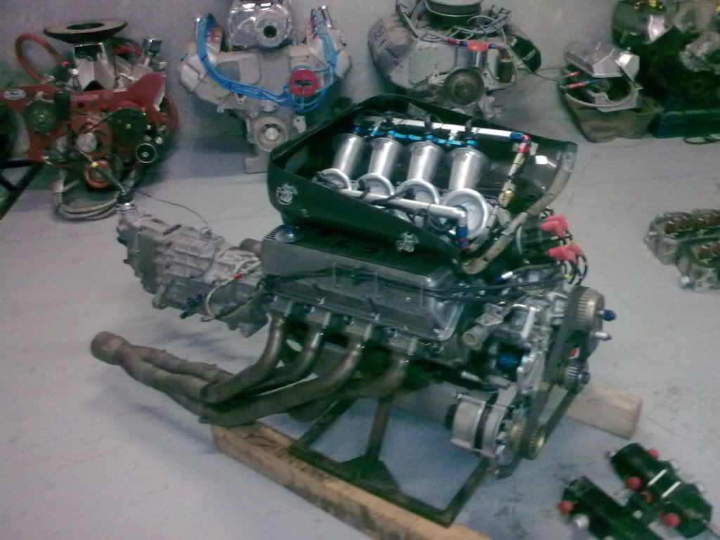

peter mc Posted January 10, 2011 Posted January 10, 2011 this is from a L28 that i believe is the most power productive engine in aus it makes 265 hp at the wheels at 6000rpm Quote
Riceburner Posted January 10, 2011 Posted January 10, 2011 Those look like the same size and length efi ram tubes I had on my triples from efi hardware. Quote
peter mc Posted January 10, 2011 Posted January 10, 2011 they work when the engine is right. big cam and lots of head work Quote
