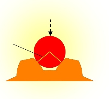

PeterAllen Posted November 29, 2010 Posted November 29, 2010 IIRC splines are measured by their number and PCD. You need to use roller needles on opposite splines and measure across the needles and then substract the thickness of one needle. I forget how you calculate what dia needles to use in the first place. As has been suggested you are best to use the mating part as your guide. Quote
