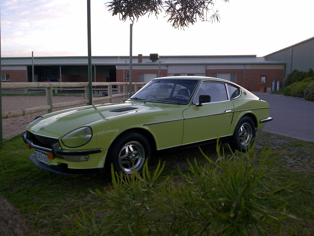

WA240Z Posted September 22, 2010 Posted September 22, 2010 Hi all, I have a 73 240z with the extra orange blinkers mounted on the bumper bar. Question for early 240 owners, are the blinkers working through the park lights, i.e. no park lights, or is there two separate globes in the early park lights? I would like to change mine to get rid of the extra blinkers to create a cleaner look. Quote
Scoota G Posted September 22, 2010 Posted September 22, 2010 Hey can you post up a photo of your setup so we can take a look, you might have a rare setup there. For Australia anyways Quote
WA240Z Posted September 22, 2010 Author Posted September 22, 2010 Yep, good idea. Cheers, Billy Quote
Scoota G Posted September 22, 2010 Posted September 22, 2010 Well i'm going to unusually critical here... it all looks a bit busy hey? The side strips i would ditch. Door refectors / protectors, Yuk. Front chrome strip on bonnet ... gone. Mirrors. well Nup. I think the indicators are fine it's just all the other add ons that make it suffer, love the color but it's just so unusual. Mirrors are very 80's cheap ones like i had on mine when i bought it. Hey it's just my opinion. Still a very nice ride just dosen't need all that bull crap on it. Quote
Moderators Zedman240® Posted September 22, 2010 Moderators Posted September 22, 2010 Those bar mounted indicators only came on the 73 model like yours so I'd keep them; they are unique for your model. I agree with the side strip thing...very old man Holden HQish..just my opinion as well.. Quote
WA240Z Posted September 22, 2010 Author Posted September 22, 2010 Well i'm going to unusually critical here... it all looks a bit busy hey? The side strips i would ditch. Door refectors / protectors, Yuk. Front chrome strip on bonnet ... gone. Mirrors. well Nup. I think the indicators are fine it's just all the other add ons that make it suffer, love the color but it's just so unusual. Mirrors are very 80's cheap ones like i had on mine when i bought it. Hey it's just my opinion. Still a very nice ride just dosen't need all that bull crap on it. Scoota G, I agree with your comments, mind you I have lived with them for some time now. I am finally getting around to getting the car looking and going exactly how I want it rather than just keeping it in good condition mechanically. Currently looking for OEM left and right door mirrors. But back to my original question of the early blinker / parker lights, what was the setup? Quote

Jimbo Posted September 22, 2010 Posted September 22, 2010 G,day WA240z , My 11/72 has the orange blinkers the same as yours but mine are mounted above the front bumper not underneath like yours...Jim Quote

D.O.G Posted September 25, 2010 Posted September 25, 2010 G,day WA240z , My 11/72 has the orange blinkers the same as yours but mine are mounted above the front bumper not underneath like yours...Jim Just by way of confirmation, I also had an 11/'72 240Z that I bought in '78. The orange blinkers were mounted on top of the bumpers..............and I thought they looked fine. Pete. Quote
