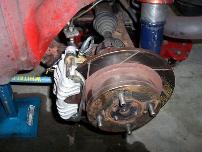

Just another bit of positive feedback for Better Brakes in Cheltenham. Just recently got my rear R31 calipers and some braided lines made up for $180. Its so much easier to just hand in the old ones, get them reco'd and then just bolt them on, bleed and drive away! Also worked out a way to hook up the handbrake cable..He is always good for some advice, as long as you have spent some $$$ or purchased something. In his office, behind the counter is a sign;

Cool looks good. I hate drums myself this seems like the best route to go.
