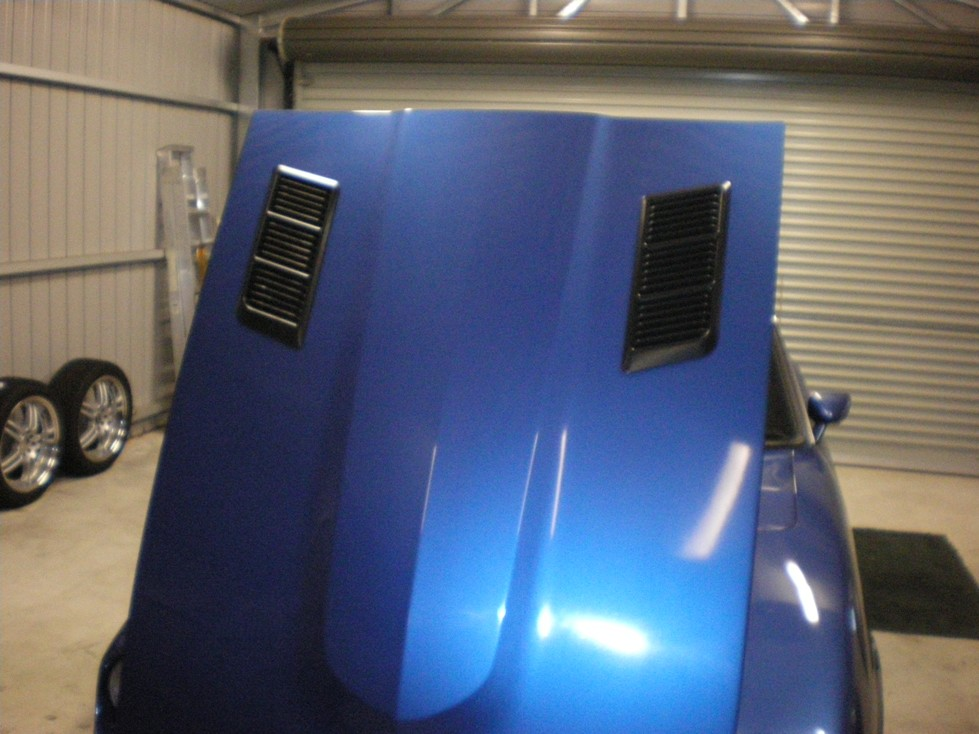

Roberto Posted July 7, 2010 Posted July 7, 2010 The late 260Z's had vented bonnets as standard. I believe Nissan still sells them new for less than $1000. Another option is to retro-fit the vents to non-vented bonnets. This is what I did with my early 260Z just recently. Quote
RB30X Posted July 7, 2010 Posted July 7, 2010 Do you have any more pics of the install? Was it easy? I noticed 260Z bonnets have an indent around the vents themselves. Quote

Roberto Posted July 7, 2010 Posted July 7, 2010 I can say now it wasn't hard, but it did take a while. I made a cut-out template on thin cardboard by carefully measuring the vent and then decide exactly where I wanted the vents to be placed. I mounted them slightly further apart than the original 260Z vents if you look hard at the pics. After that, I traced out with a texta the vent hole to be made. Then I masked off with blue tape around the tracing and used plenty of towels etc to protect the rest of the car from flying sparks. Then with a grinder with a cut-off wheel slowly started the cut. This is the important part. Cut VERY, VERY slowly to avoid heat build-up which will buckle the bonnet. This is the time consuming part and it does take a while. When the rectangular hole is cut, drill your holes and mount the vent. Do not tighten up the nuts too tightly or it may cause buckling of the bonnet. The look will be slightly different than the original 260Z vented bonnets because there is no raised surface around the hole, but it still works. I can take more pics if you like. Just tell me what you want to see. Cheers Quote
AussieZed Posted July 7, 2010 Author Posted July 7, 2010 Thanks for all the replies folks... seems like I will be able to lay my hands on one. Roberto those vents you fitted look amazing ... although the words 'don't cut too fast in case you buckle the bonnet' scare the hell out of me. Quote
