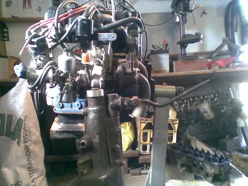

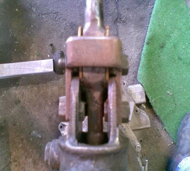

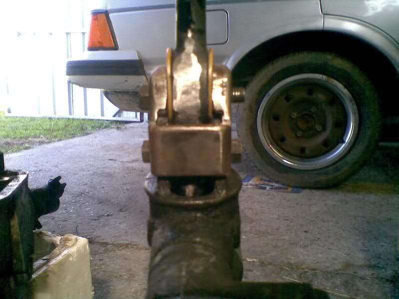

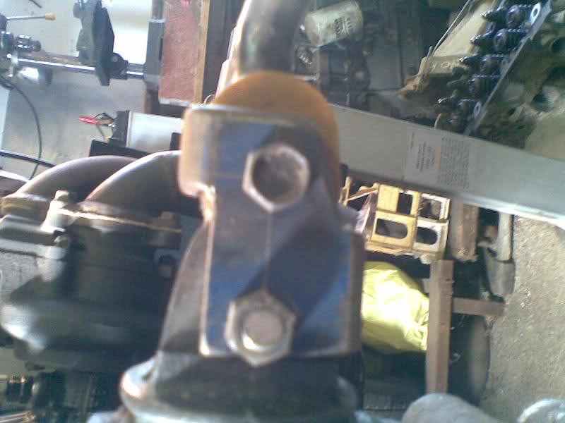

datozed Posted August 2, 2010 Posted August 2, 2010 Post a few pics of a short-shift kit that I made for my blue-bird. This was used with a full-length stick and worked well. Would be super-quick and close if used with a short stick. Have been going to make one for my Z which has a short-stick but haven't got round to it. The spacer was made of 40mmx40mmx3mm box. Stick height for the pin was extended 30mm. Quote
