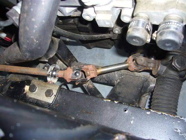

C.A.R. Posted April 25, 2010 Posted April 25, 2010 I require a new UJ in a steering column for a 240Z. It's the tiny one down near the rack. It needs to be replaced as it's got quite a bit of 'slop' in it. I reckon because of it's size it might be hard to get one? Has anyone bought a new one before from Repco/Bursons etc? Or should I try the Z specialists? Quote
NZeder Posted April 25, 2010 Posted April 25, 2010 There was a thread on this on hybridz a few years back. One of the guys in the US was having trouble getting hold of one - so contacted a steering UJ supplier and I think they made a few up - I can't recall but search over there I think there is a solution. Quote
RB30X Posted April 25, 2010 Posted April 25, 2010 To get around the headers on my car they had to add an extra uni and knuckle joint which looks the same a the factory one, so I can't imagine they'd be too hard to find. Quote
garvice Posted April 25, 2010 Posted April 25, 2010 Woodward http://forums.hybridz.org/index.php?/topic/61465-woodward-steering-joint-group-buy/ If I remember correctly the idea was that after the initial group buy the company would stock them as a regular part number. Brad Quote
C.A.R. Posted April 26, 2010 Author Posted April 26, 2010 Farking hell... THAT looks like a giant PITA... They are looking to have a whole column & UJ made (more or less). I just wanted to replace the UJ itself. Looks like I might have to find a good condition spare shaft, & fit that instead. Quote
Mr Camouflage Posted April 26, 2010 Posted April 26, 2010 Was reading something about steering joints just the other day on czc. Maybe a little better news about the steering u-joints. The 1971 240 Z has had its share of wear and tear, including steering u-joints that are scary bad. After hearing about the other attempts to get parts or fixes, I tried other ways to get the u-joints replaced. Finally hit on trying a driveshaft fixing shop. Turns out the young fellow, who does this for anything from ATV's to Class A Fuelers, took some measurements and searched around. Success! He found u-joint crosses that fit the 240Z steering rods! He installed them for me and they are perfect. I asked if I could recommend him to the other Z car folks, and he said yes. The cost was less than $50 each. I don't know if this info belongs in another area or not. But here is the info on this source: Simmons 4X4 Automotive 3743 S. Country Club Road Tucson AZ 85713 Phone: 520-884-0217 Fax: 520-792-2997 SIMMONSAUTOREPAIR.COM http://www.classiczcars.com/forums/showthread.php?t=25012 Quote
